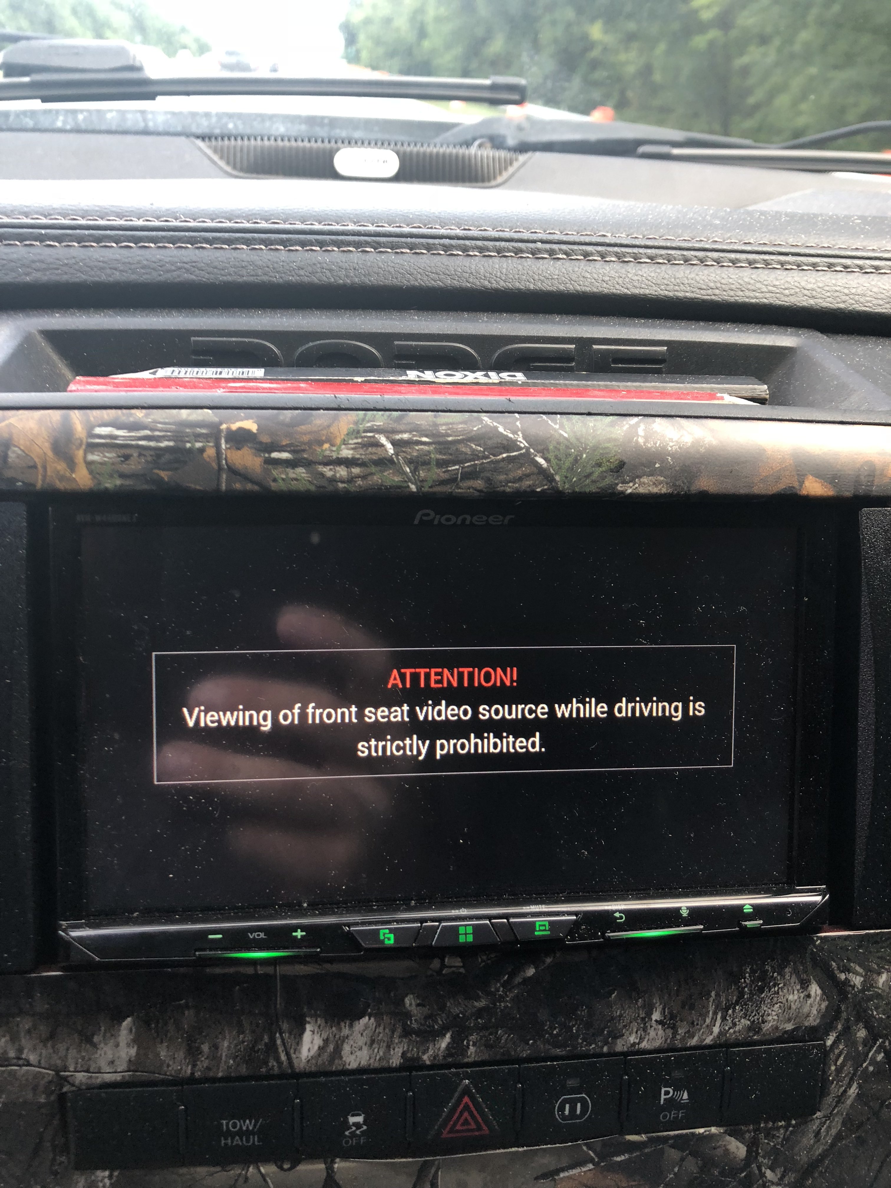

All I'm really concerned with us to play video on the rear monitor out so the kids can watch a movie in the back seat. Has anyone verified if the dual output will output video when if driving? Subscribing to hopefully find an answer.
w4400nex how to bypass e brake
I have read others success by simply disconnecting VSS and GPS.

Yes I do believe so. Update the W4400NEX to 1.01 and after reboot...
Do the AVIC "SET ON" bypass in the lower left screen that everyone is already familiar with.
On 12/7/2018 at 12:47 AM, krankintacoma said:Yes I do believe so. Update the W4400NEX to 1.01 and after reboot...
Do the AVIC "SET ON" bypass in the lower left screen that everyone is already familiar with. Also, I believe a micro bypass is still required on this headunit as well.

you just need the latest firmware which is 1.01 and then the SET ON bypass works by pressing and holding the bottom left corner for a long time. this worked for years on Pioneer head units but was not in the original firmware on the 4400NEX but was put in in firmware 1.01
On 12/9/2018 at 10:46 PM, tubatransport said:you just need the latest firmware which is 1.01 and then the SET ON bypass works by pressing and holding the bottom left corner for a long time. this worked for years on Pioneer head units but was not in the original firmware on the 4400NEX but was put in in firmware 1.01

Hold the lower left screen (quadrant) for exactly 10 seconds.
So in summary it worked after updating to firmware 1.01?
Yes!!! Finally. Thank you so much.
As no one responded, I did the test myself, updated to 1.01 firmware, then did the "SET ON" bypass in the lower left screen and voilá!!! Video input works when car is moving. Way to go.

Update on my install: I pulled my head back out yesterday and realized that my remote trigger wire had pulled out of the connector. After I fixed that, everything worked. So I have the pioneer 4400nex, google pixel2xl, and microbypass installed. I have GPS antenna connected. I do not have the VSS connected. Everything is working fine. My AA works great, and wireless AA works well also. I still couldn't watch video in motion, like others I could see it until about 10mph then a warning screen would come up. So I updated the firmware on my head unit and did the "set on" input and now I can watch video at any speed. I would like to thank everyone who has posted information about these issues as it has guided me to this favorable ending to my install. Let me know if you have any questions about something I may have left out.
