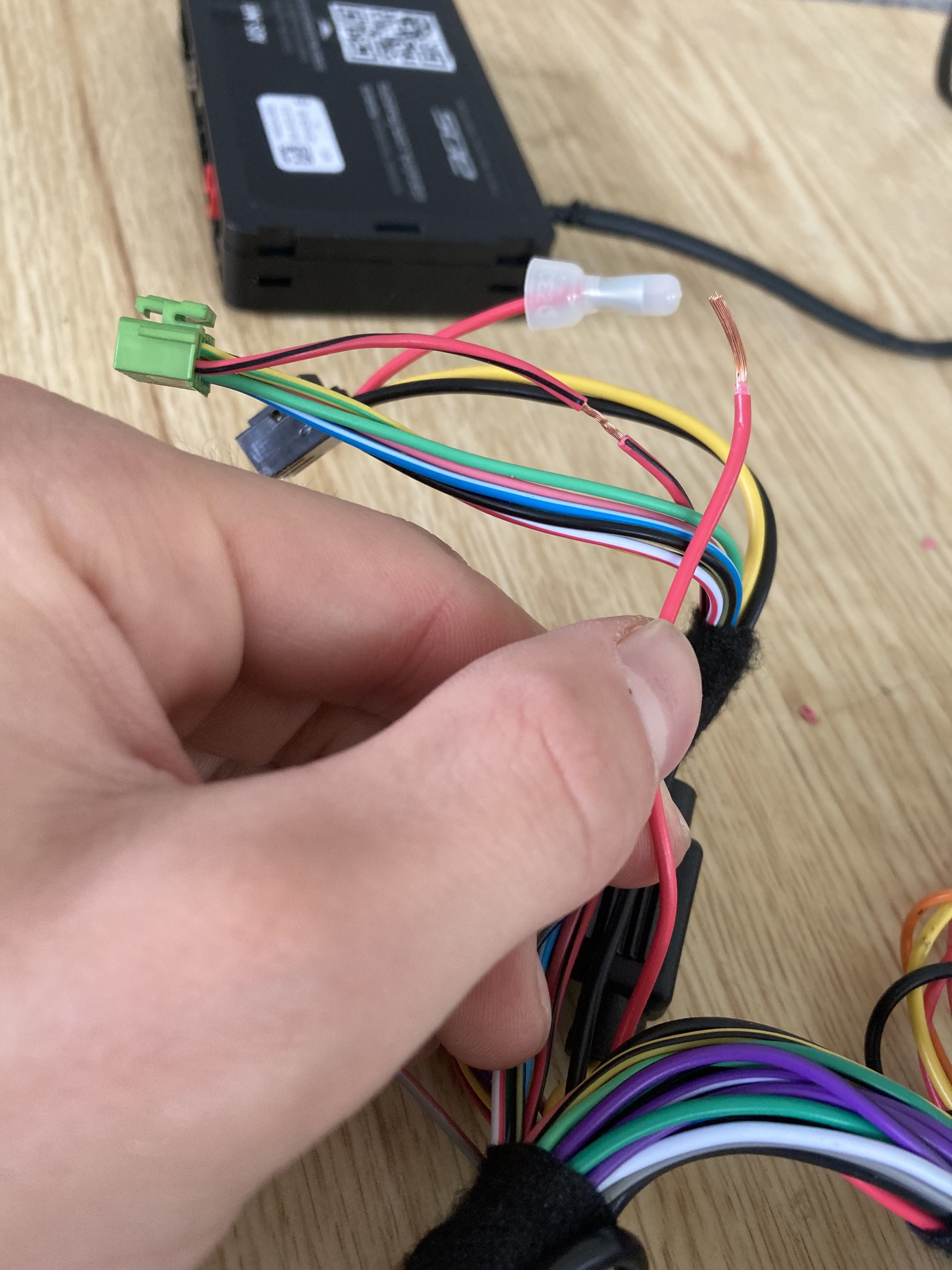

On 5/3/2020 at 1:34 PM, Tiredhands said:
Sorry, following up Again. Made a jumper from the black/red wire to the red wire from the radio and capped the end going Into the RR per Maestro support. This will isolate the issue if it’s actually maestro related or radio related. Pretty sure the power goes directly to the radio now and not though the maestro. We’ll see if this fixes it.
Still no reboots? I’ve had a few with the maestro and new WT7600NEX.
What’s the best way to tap into that black/ red wire? I’d like to cut it and solder/ shrink wrap. I don’t think I have the skills to strip it back and not cut the wire like you did!
I tried it a few times to practice on a spare wire of similiar gauge.
