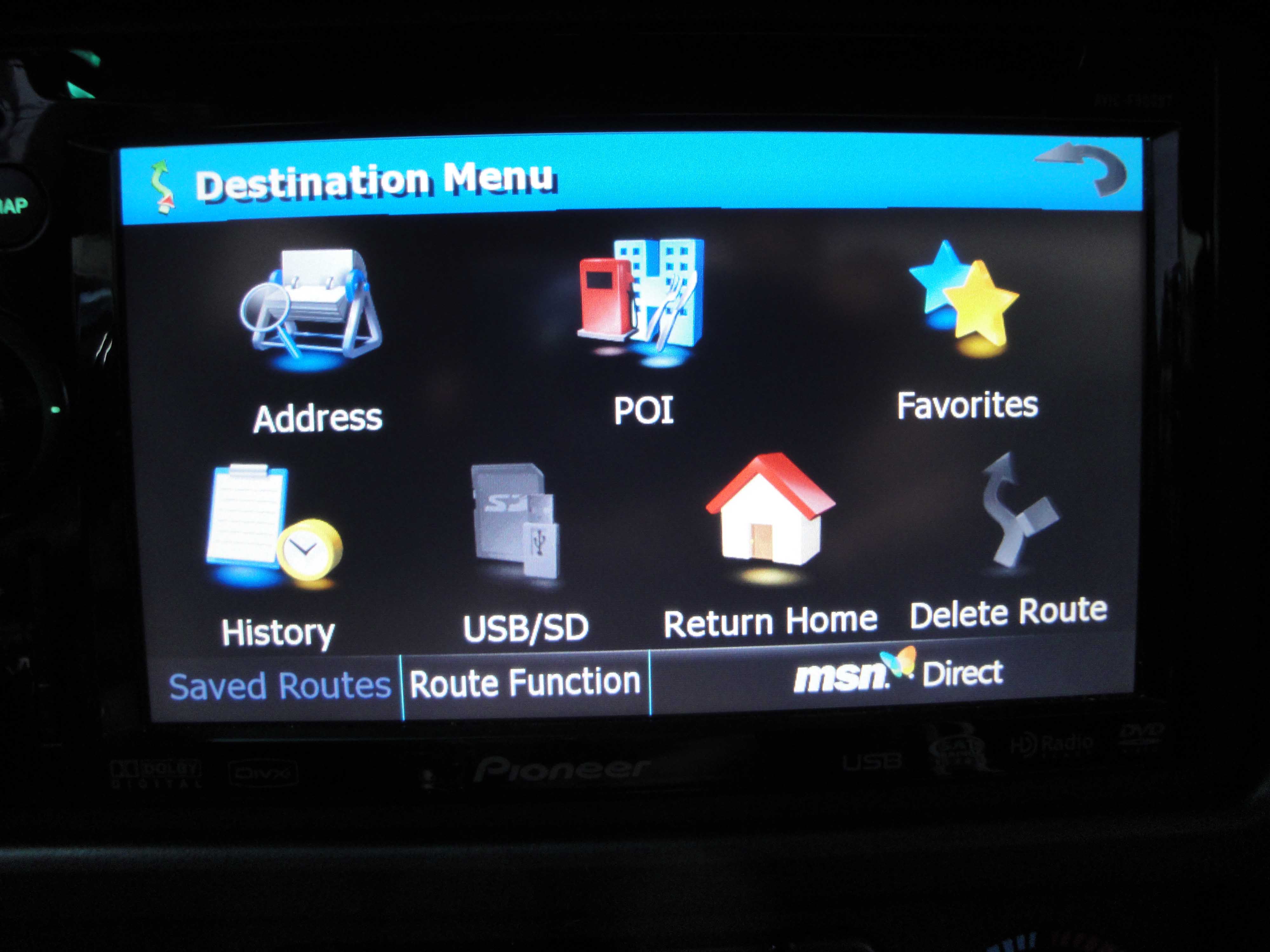

Need help moving these bmp's
in Hacks/Mods
Posted
I am trying to either move the top blue bar up a little or the 3 icons (address, poi and favorites) down a tiny bit since if you notice in the top picture that the icons interfere with the blue bar. Does anyone know where in the data file I would be able to adjust the y value of these bmp's. Thank you
