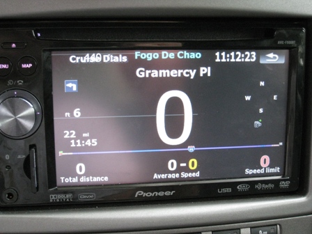

Alright - this is how you get it to show up.
In the state area (say speedometer.ini in the common folder) or wherever you are putting it.
You need this line in the uselayer section:
Then you need to have the init script put it where you want it:
the ui_Route.y moves it to a variable position - the variable being d_slrouteDS_y. The last thing that needs to be done is in the 800_480 file - need to define where the y location is for that variable.
So - in my example the Speedomter_800_480.ui has:
Which places the bar at the y location of 352.
Worked pretty well for me. the ported speedometer extension now has the route bar on it..
Here are the two complete files so far - need A LOT of work:

You probably already did this, but just to make sure - grab the speedometer.ini and speedometer_range.ini out of the 800_480 directory.
Nice catch on the template line, must have forgotten that one step on the previous post...
Also, the Speedometer ui files are for a different view I'm working on. it's the digital speedometer screen that looks like this:
Thanks,
Ben
That worked great. Thanks IDT.
Speedometer is now working/etc... I was missing the speedometer range attachment...
