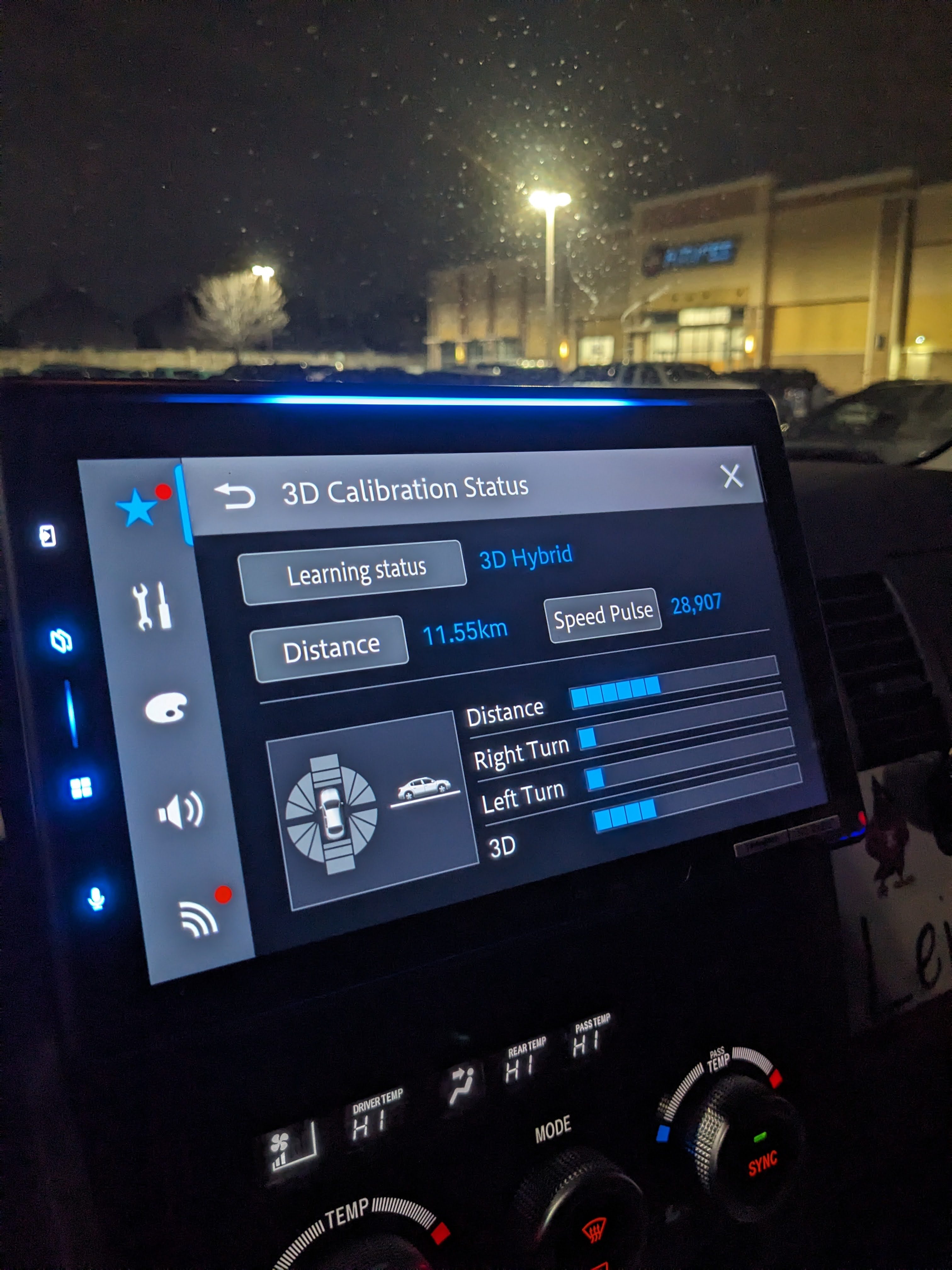

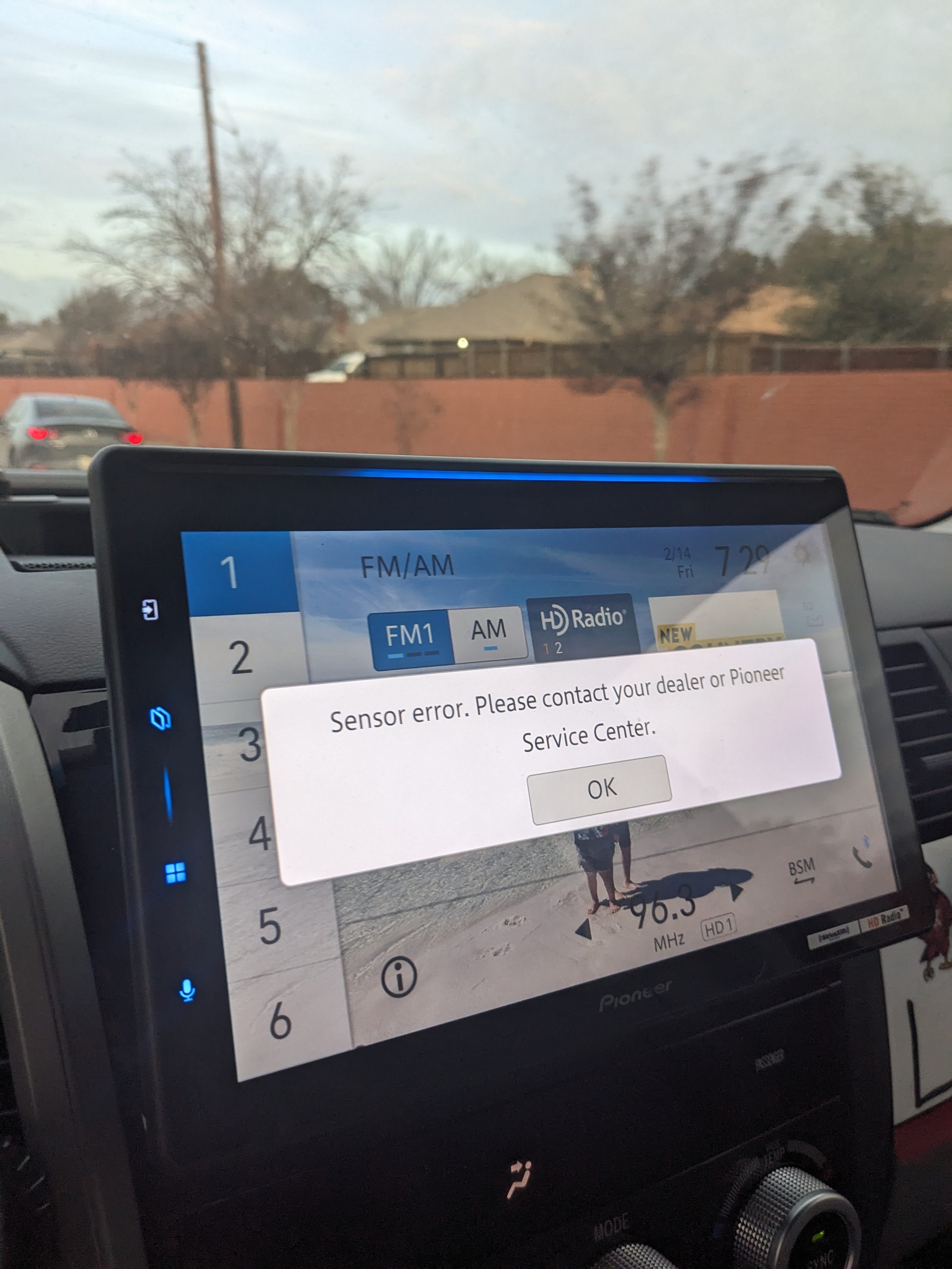

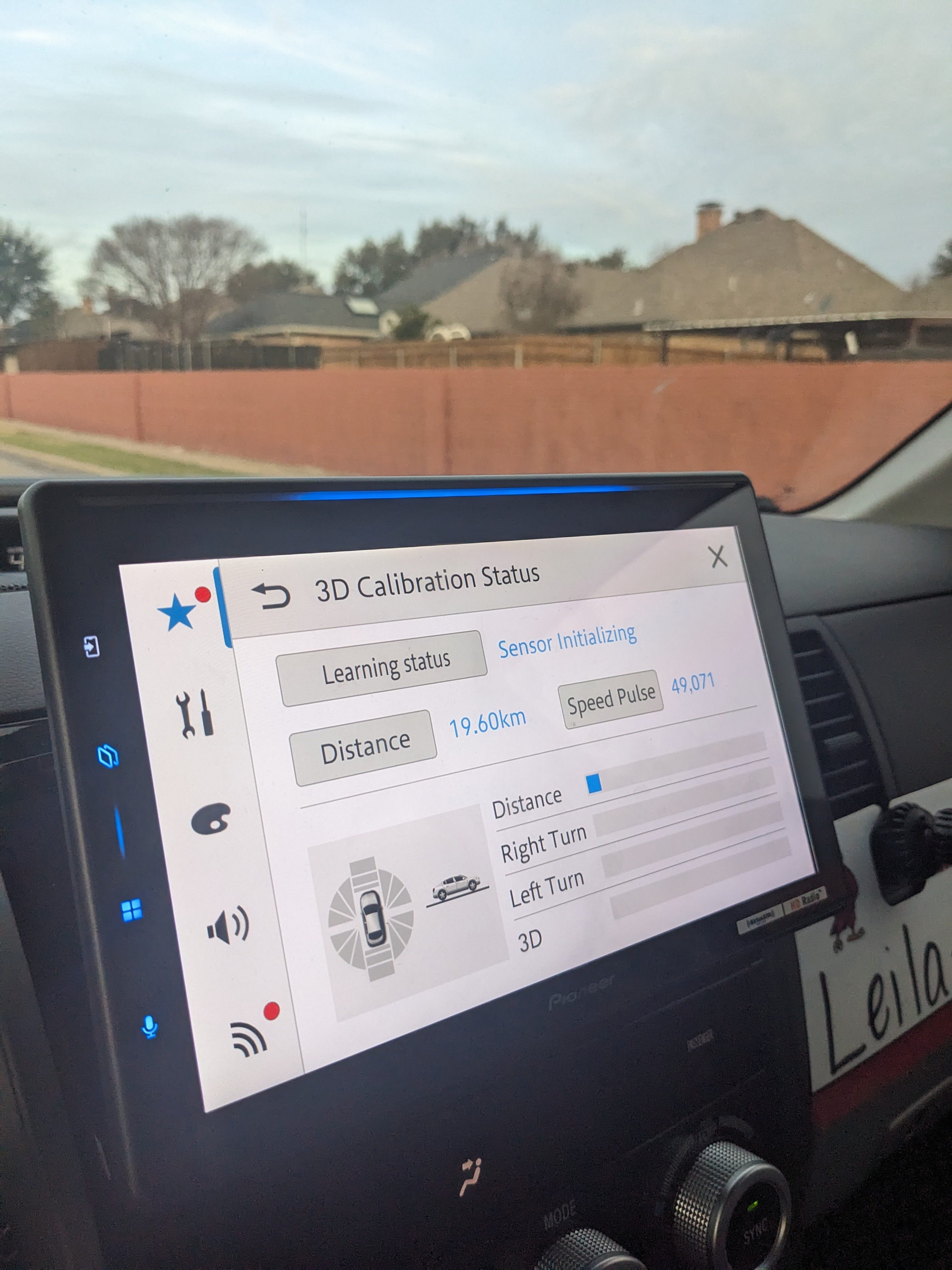

Having an issue with 3D Calibration.  In summary, the system never finishes calibrating and within 15-20 minutes of each drive cycle I get the following message, "Sensor error.  Please contact your dealer or Pioneer service center."  This causes the LEARNING STATUS to go back to SENSOR INITIALIZING and resets the bars.
When I go to CONNECTION STATUS everything appears normal.
GPS ANTENNA:  OK
POSITION STATUS: 3D POS. X25 (ORANGE) X32 (YELLOW)
INSTALLATION: OK
SPEED PULSE: OK
LEARNING STATUS enters 3D HYBRID within a few miles of driving and DISTANCE and PULSE counts are increasing as I drive.  The bars are also increasing, slowly, but are increasing.  Never seen them reach full calibration.  I've reset LEARNING STATUS, DISTANCE, and SPEED PULSE several times and that doesn't fix it.
The GPS sensor is properly mounted on the dash on the metal platform that came with the unit.  I've verified I am on the most up to date firmware... I can't figure this out.. Any help is appreciated.
