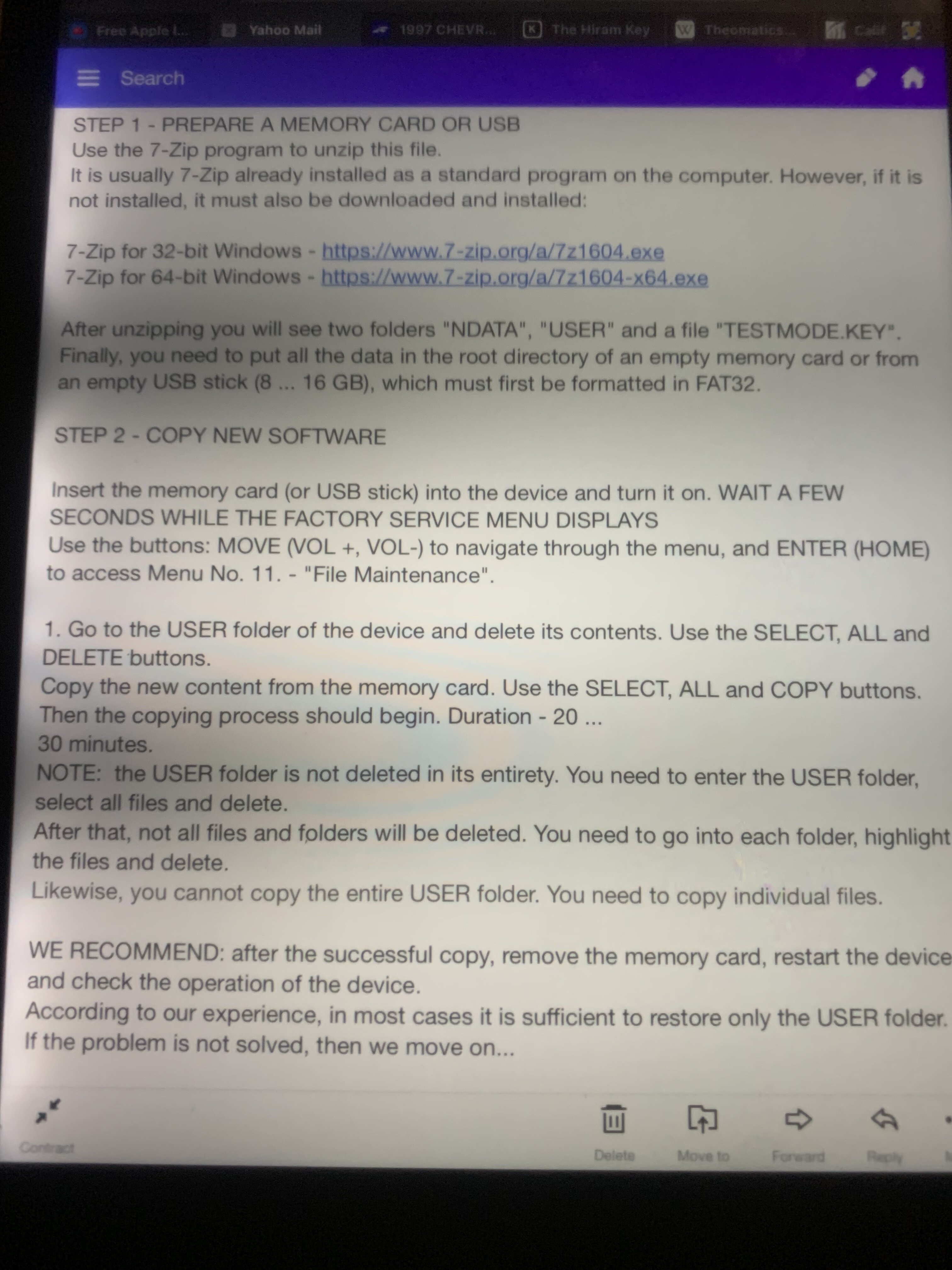

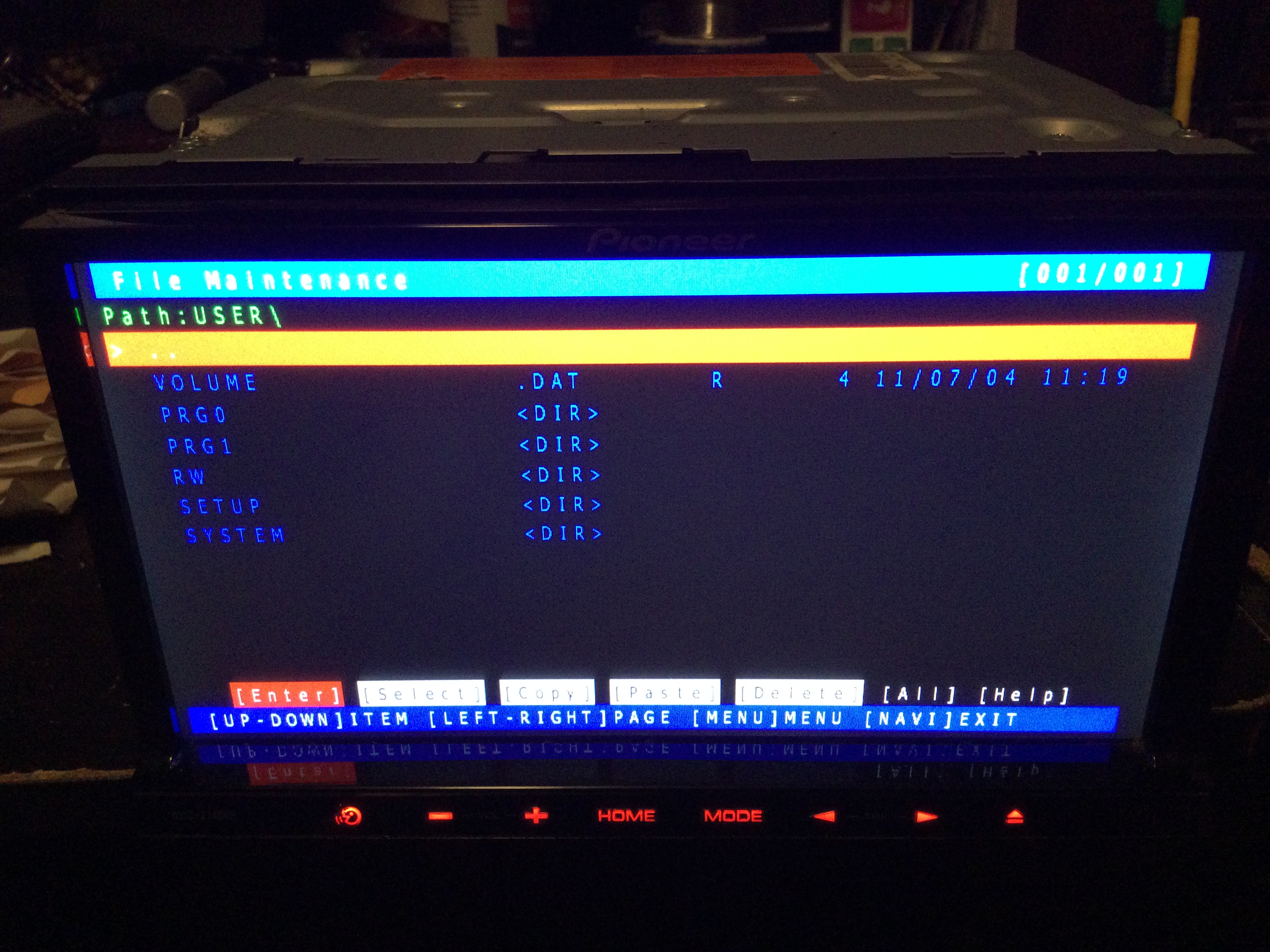

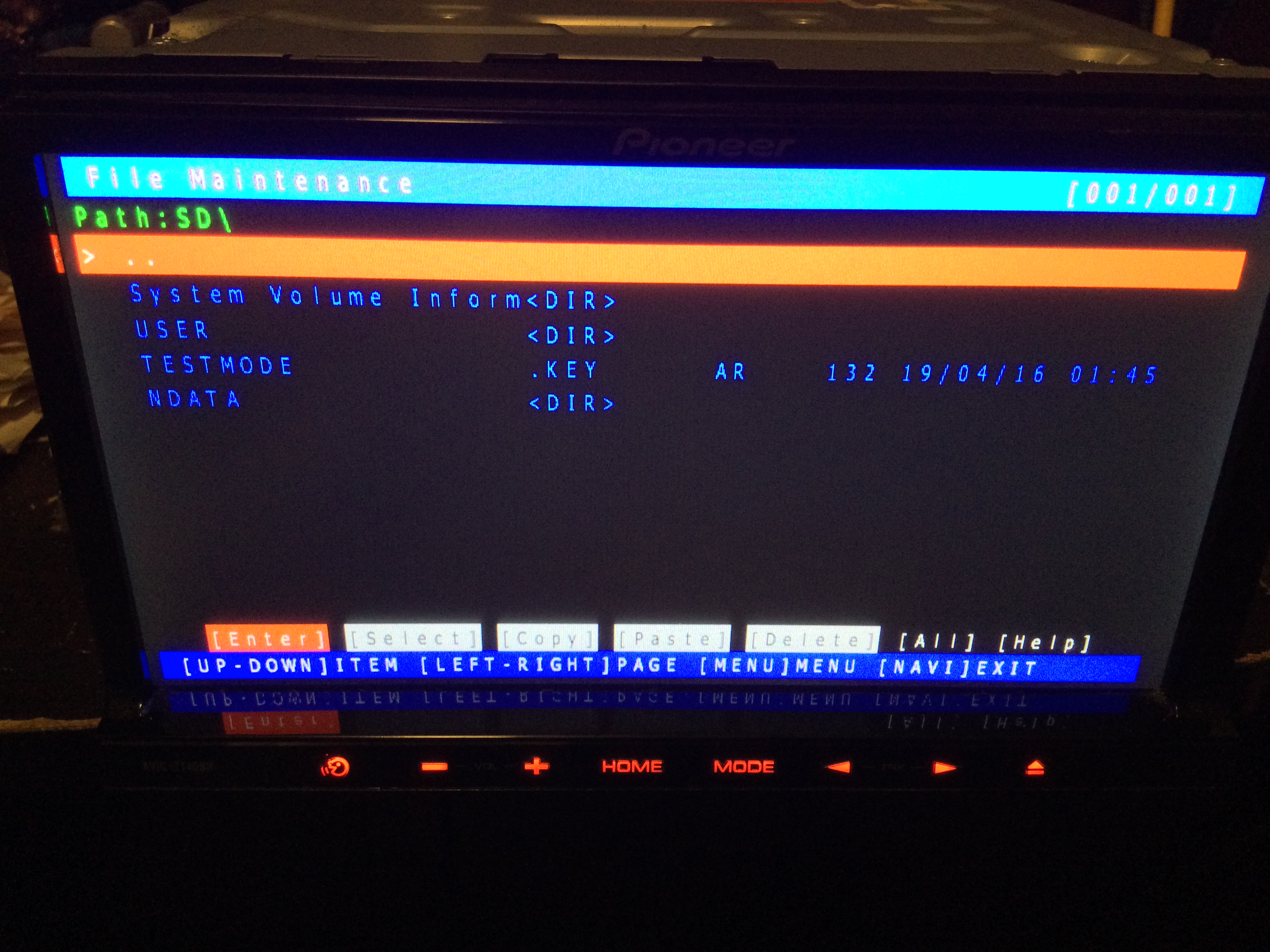

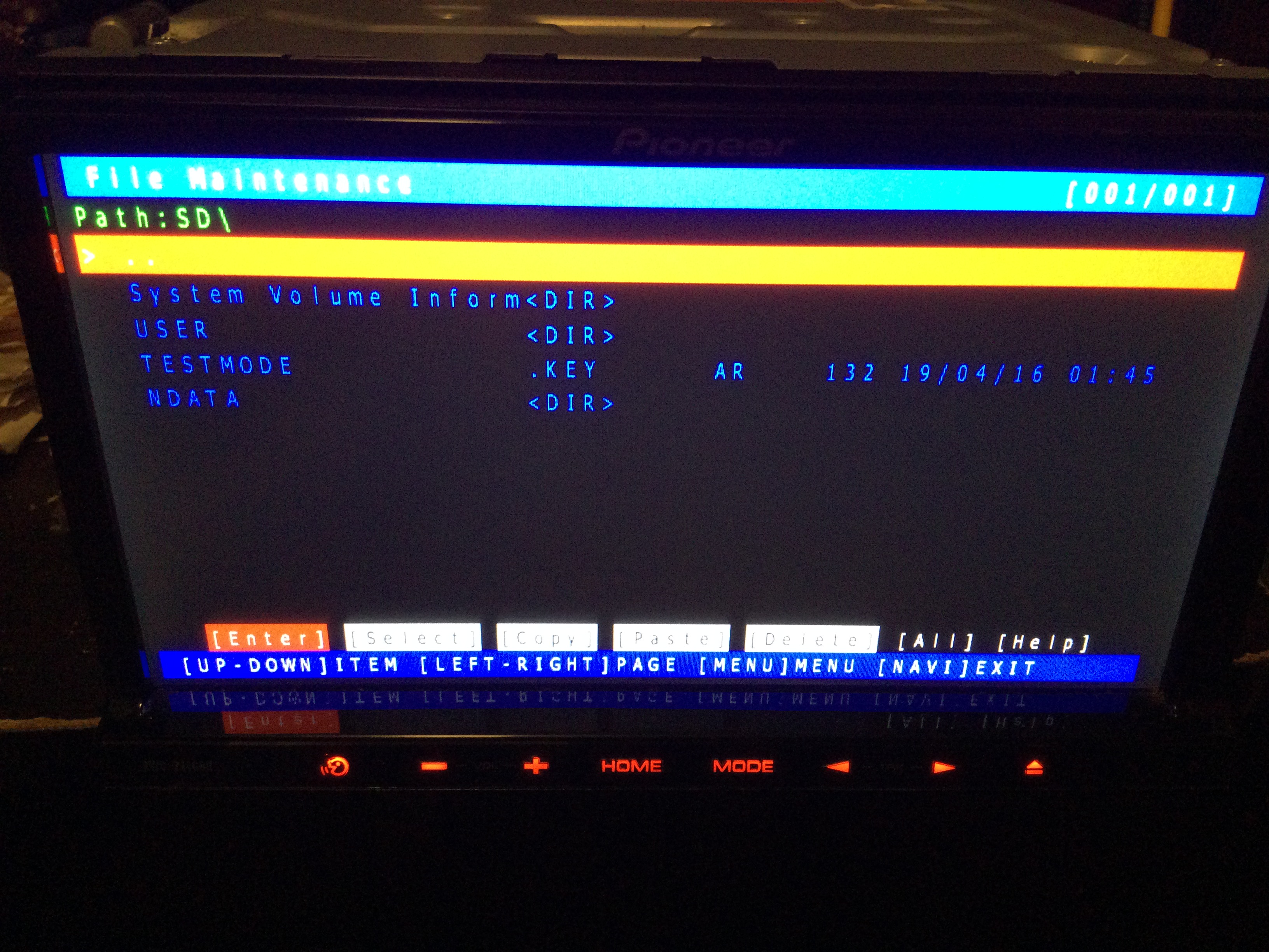

Rest91 Posted February 20, 2025 Report Share Posted February 20, 2025 I Have a couple units with the “No applicable program message” I bought the program service files from “Denavi”, I followed instruction but somehow when I try to copy and paste after deleting it won’t Paste. Instructions say 30min, I’ve waited 30min time after pasting but it still won’t show up. Am I doing this procedure correctly? I’d be more than happy with any helpful tips from users who experience this issue. Quote Link to post Share on other sites
