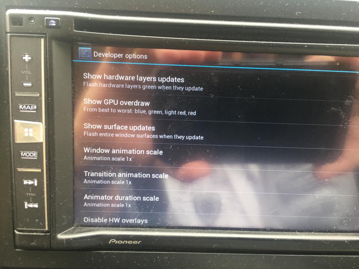

Following The AVIC Development Mod, we would like to introduce a new Debug menu that was discovered by examining the Av.apk. This mode seems to be one of the developer menus that Pioneer themselves used to develop the software. It seems to be compatible with all decks that The AVIC Development Mod is compatible with.
This menu includes but is not limited to:
USB OTG Switching (We have yet to see this truly working)
Boot Mode Changes (No need for bsp flashing)
Stock Android Developer Settings Menu
Sensor Debugging
Logcat Log Levels
Component Logging
Creating the WARP Snapshot
Creating the UserData Snapshot
Saving off the device database
Saving off logs
Displaying CPU usage imanformation

​Select Off in the Source Settings
There are 3 invisible buttons on this screen. See the image below for a picture of the screen, with the Layout Guides Enabled.
There are 3 boxes in the center screen those are the invisible buttons, for reference we will designate them buttons 1-3 left to right.
Enter the following sequence on the buttons: Button 3, Button 1, Button 3, Button 1, LONG press Button 2. The first 4 presses should be normal button presses, not long presses.
When done correctly you will receive a password prompt. Enter DEVELOPDBG ON There are 2 other passwords but they have just a subset of the options that this one has.
Click Ok.
You will be taken back to the Off screen. Press and hold Button 2.
You should now be in the development menu.
