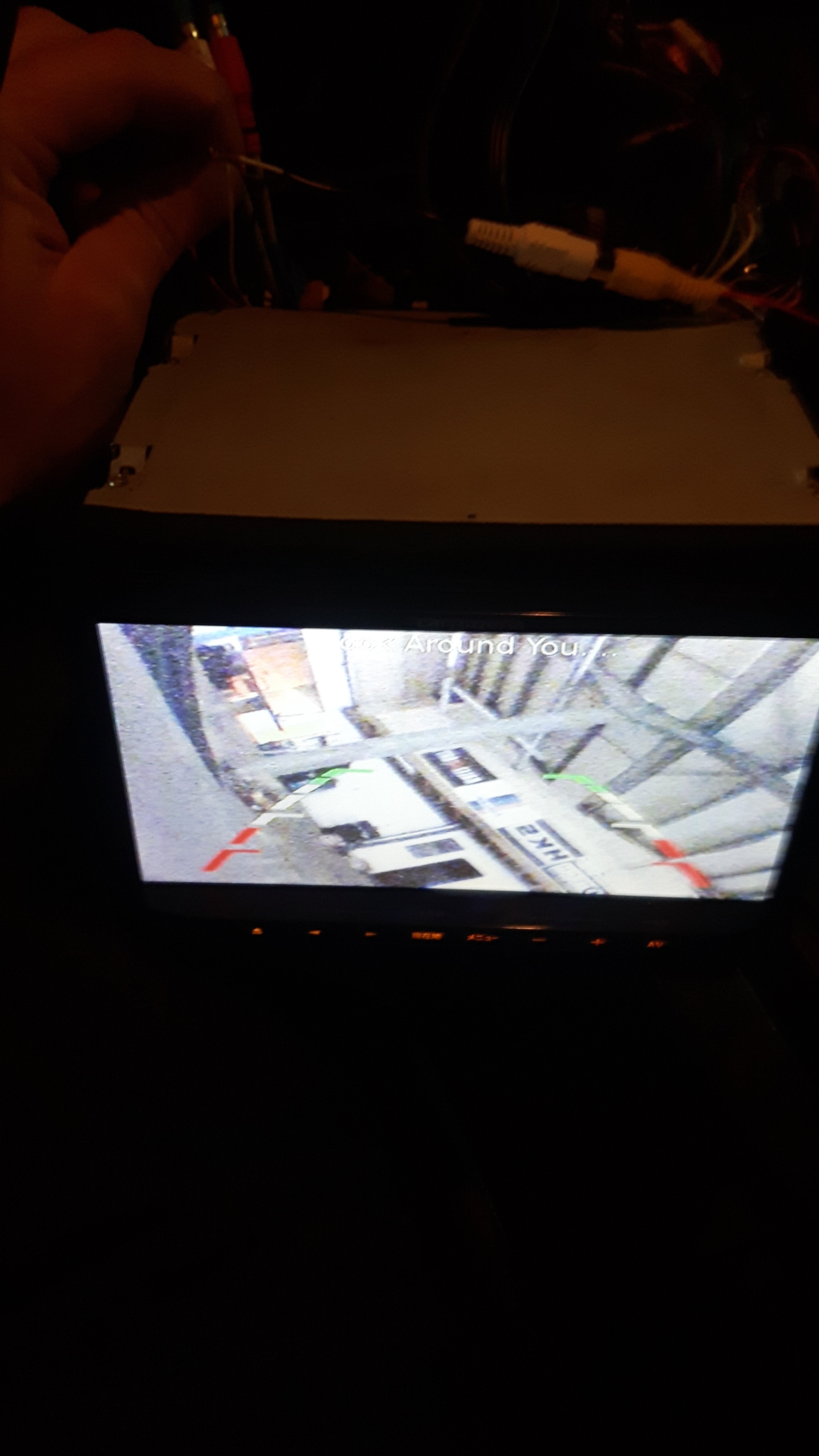

gamerbom Posted January 31, 2018 Report Share Posted January 31, 2018 Hey all, maybe somebody done this before but i cant find any corect info.. i bought reverse camera with rca connection but i dont know how to conect it with my avic mrz99.. mg radio have conection with 4 wires red, blue, black and white, i cut them off, bought rca cable but i dont know hot to connect them.. any help please.. Quote Link to post Share on other sites
switelolo124 Posted February 12, 2018 Report Share Posted February 12, 2018 HI Show me both connectors, or just that connector with colours of that cable that you cut. Sorry for bad eng, PL here. PS. Hehe i have also 2din in e36 and its look awesome Quote Link to post Share on other sites
gamerbom Posted February 15, 2018 Author Report Share Posted February 15, 2018 This is conector wich i cut its in photo and i want to connect rca to him its universal video cable wich have all back wiew cameras Quote Link to post Share on other sites
gamerbom Posted February 20, 2018 Author Report Share Posted February 20, 2018 Connected! White wire to the RCA cable signal, black one in to RCA cable ground(not nessesary) and the purple wire with white stribe from radio wires to 12v from reverse gear swich. Thanks a lot switelolo124 Quote Link to post Share on other sites
