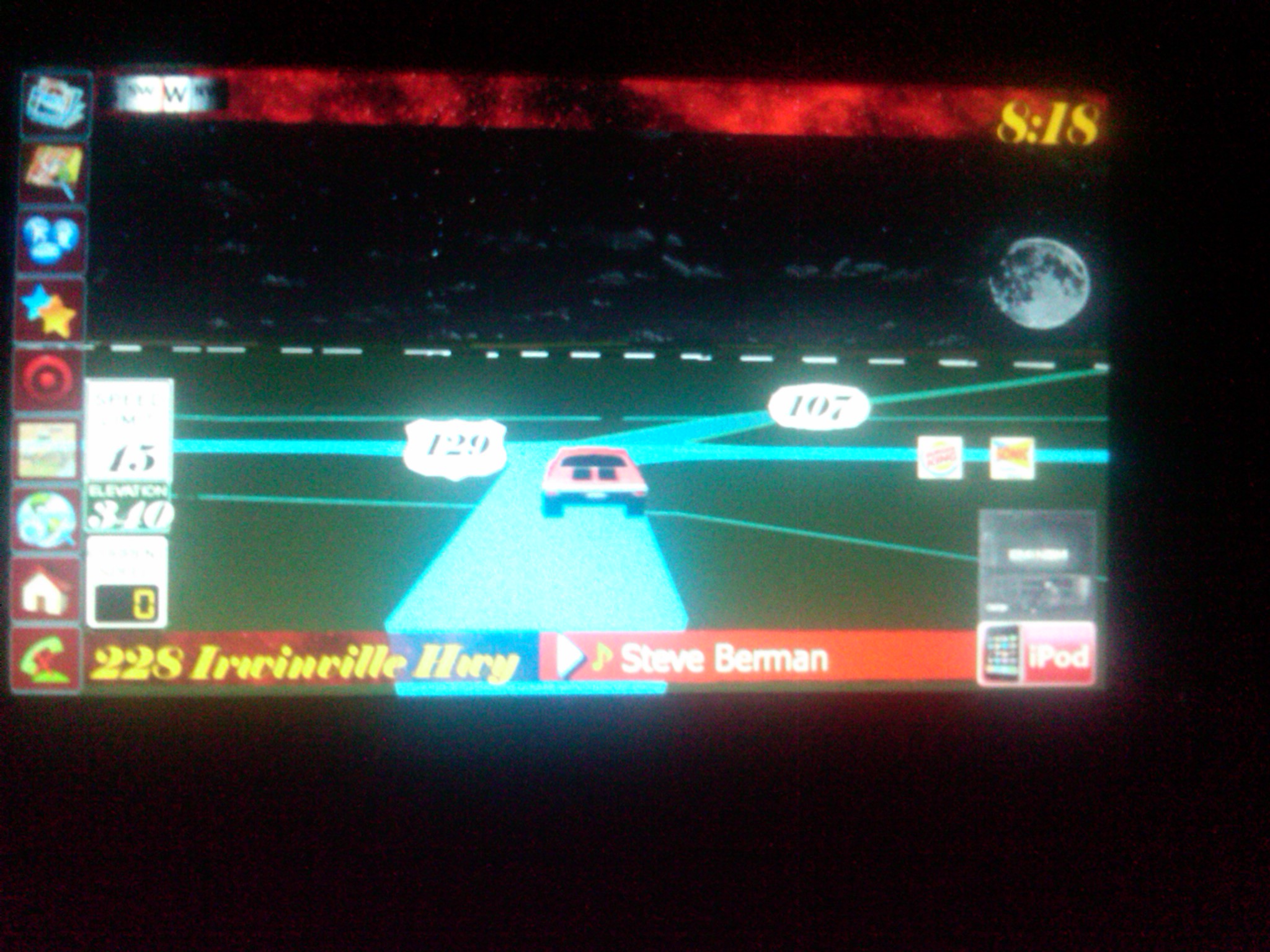

Posted Mar 08, 2010 · 01:44 UTC#19
Changing the values is the way to go...photos a little fuzzy but it definitely improves the overall experience. Seems to lag a little... It seems as though some pop up just after i pass them while others appear far ahead of me.
Posted Mar 08, 2010 · 03:24 UTC#20
As you get closer to the POI the angle changes which will reveal the ones that are crowding together as they move out of each others view.
