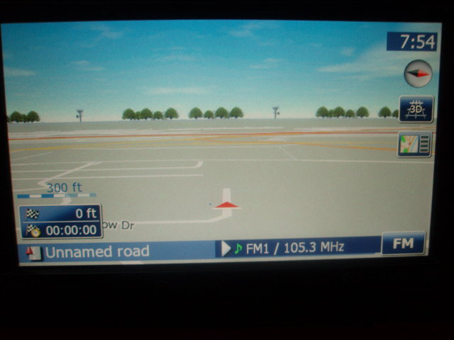

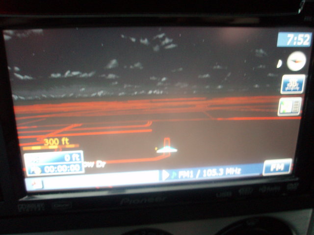

Ok if you guys want skies on your 3.0 unit here is how: Copy and replace the attached sys file in my flash disk/apl2/igo.
Then go into your data.zip file and replace the gfx file with the one also provided in the zip file attached.
Then you have to modify each scheme color.ini and color3d.ini. Copy and paste this code below, under [other] all the way at the bottom in the color.ini files.
background_picture_0="gfx/day/cs.bmp"
sun_picture_0 = "gfx/day/sp.bmp"
This code just shows where the files are for the background to be displayed so you can actually pick other bmp's to use. The one above is for a day background, so you would have to use "gfx/night/whatever bmp for night you want to use"
Have fun modding! :D

eurotuner29:
I followed your instructions perfectly and I have run into a small problem. After I loaded the new DATA.ZIP, SYS.TXT, and all of the scheme files (the four color.ini and four color3d.ini), I booted my unit up.
After my splash screen goes away, a small WinCE window pops up and says something about application data or application memory or something, I can't read it because it goes away really quickly and then the main menu comes up. Once the menu loads up, the "System Starting" message just hangs on the screen and doesn't go away. I am able to push buttons and all, but it stays on there.
I used the proprietary Windows 7 compression to decompress the originals and recompress the new files. I think the F-series is very picky about its file compression. What do you use to decompress and compress your ZIP files for the unit?
Use Winrar
Posted Jul 22, 2009 · 18:58 UTC#14
Awesome, I re-compressed the files and it all works beautifully. I love this mod.
Thanks for your help guys!
