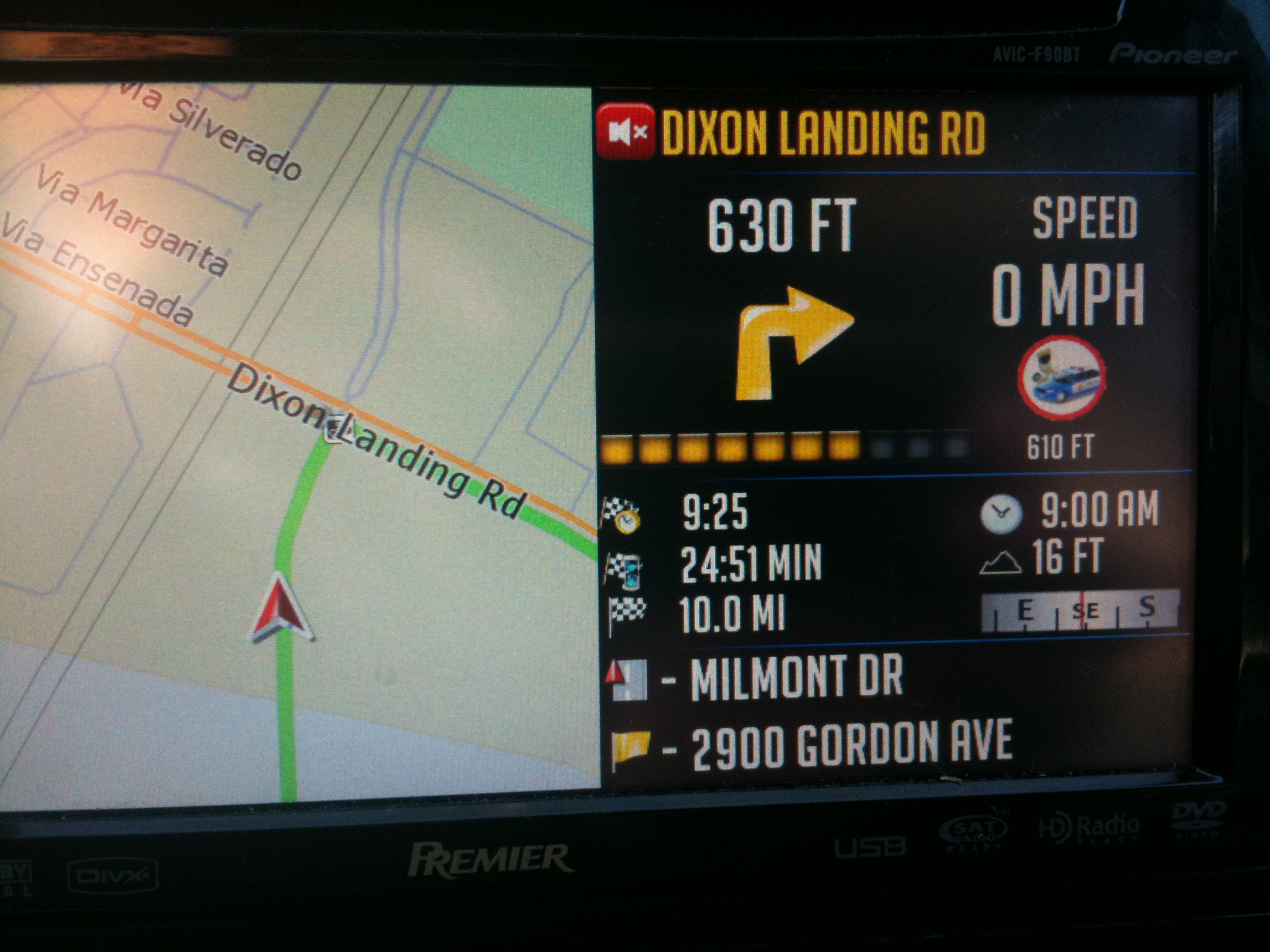

These mods were tested and made on a US based F90BT running 3.01.
I did a lot of coding on this to make additions and adaptations to what was there but the original mods are done by the following people:
Keeper, Stanislavovich, N-S-E-W, andr2000, and BorisM.
This zip contains DIAFTIA's Hybrid mods all in one:
  • 1. My mods run on Stanislavovich�s/andr2000 mods.
    2. This new release features the Stanislavovich tripcomp and Tripdial, the speedometer by Keeper, Diaftia derived from the Gurjon skin, the ported Multiroute from Diaftia, menu from keeper, tripdial from Gurjon, onscreen trip computer by IDT, and a bunch of other things.
    3. Updated default schemes to support multiroute functionality rendering in different color on the map.
    4. Software bypass for those of you who haven't done a complete hardwire bypass. This also includes a fix for those of you that have the parking brake wire connected still.
    5. Branding.zip file updated by flyboyindy. This will give you icons on the map if you enable them that are the actual brands rather. For example you will get a Chevron logo at a Chevron station rather than a gas pump icon for a gas station. If you don�t want them don�t copy the file. This includes VBLUE24�s red diamond icon fix in the main config.
    6. Left/Right destination announce, speedcams, and all the other goodies are in this.
Initial 2.0 release:

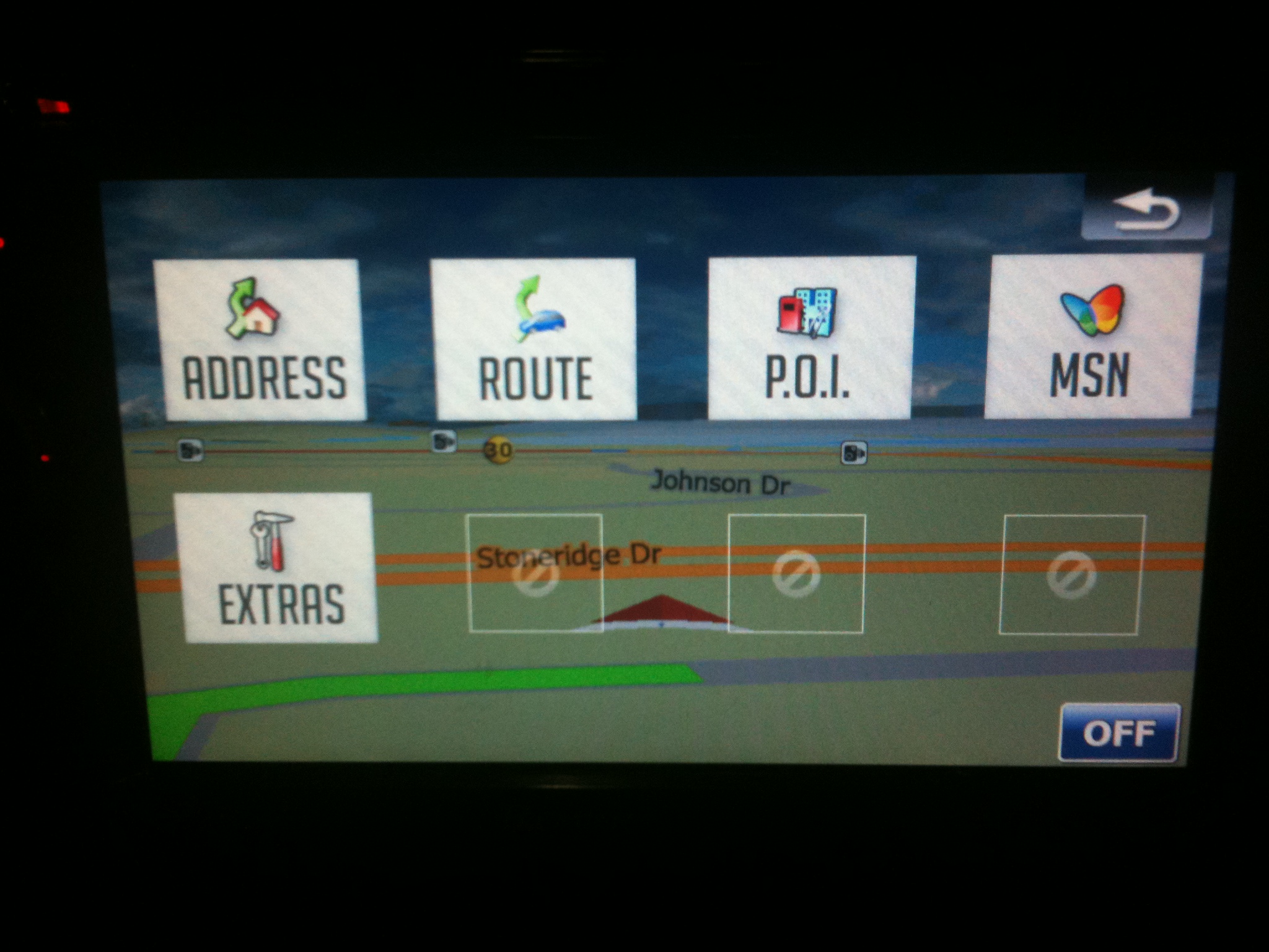

  • New menu system including adding a route section and new poi search icons and back button.
    Brought back the cool speedometer screen and added icon. If you want this on the map just instead of on a background just comment out the background in the navigatemap800 file.
    Toggle for illustrated text (freeway and exit signs can have logos). On some 700 units the text appears colored in. Turn this off and they will go back to normal.
    Toggle for solid or opaque backgrounds when navigating.
    Fix for when going 2d up not staying centered when signpost appears.
    New custom search button that goes directly to a search box and does a large radius search in all categories. From what I can tell it will go out at least 450 miles.
    Fixed the searching bug from the old version.
    Added Screen off with clock
    Added onscreen trip computer (touch the clock to display it)
    Current street can now be toggled on, off or only when navigating.
    Settings menu's completely redone so they are easier to navigate. With all the customizations the screens were getting very long.

  • New split screen navigation option. Accesible via the extras menu.
    New smaller lane info arrows when choosing them at the top. They also do not appear under the signposts but rather beneath them.
    Layering issue with current street in plan mode fixed.
    Fixed the blurry navigation images. The arrows were good but the checkerd flag, roundabout, and other images were blurry.
    Added bluetooth icon to alternate nav and speedo screens.
    Fixed bug where elevation was not showing in feet on speedo and cruisedial screens when using modded ezrider.exe
    Made "time to destination", "distance to destination" and "eta to destination" all larger font on both main screen and speedo.
    Added back to nav screen button and zoom in and out buttons to the plan mode screen.
    Removed trip computer button from cruise dials screen and added route progress meter.
    Made the time and date on the off screen pop a bit more so its easier to see while still trying to keep the screen dark.
    Keyboard fix (I hope) for polish keyboards.
    More minor perfectionst tweaks
1/14/10
  • Speedcameras now display in smaller format when signpost is up so there is no overlapping on the freeway. clicking the signpost removes the signpost as usual and restores the speedcam to their original format.
    FINALLY fixed the problem where supressing a speedcam type would still have the distance to speedcam appear on the map.
    Added a quickmenu for some system and route settings. Activate on long press of quickmenu button.
    Changes, updates and bug fixes to the split screen.
    TMC button created for EU users (Merten3000 needs to update)
    Multipoi icon fix

Looks good. Hopefully all problems have been solved. Will try to get updated when I can. Been sick. :cry:
This is what I meant with the PM I sent ya. Is the compass supposed to be there, or is it supposed to be moved lower a bit to fit inside that black area?
Posted Dec 01, 2009 · 20:29 UTC#5
Ah, I thought you meant left to right. I guess it could be moved down a tad. I will make a note of it.
