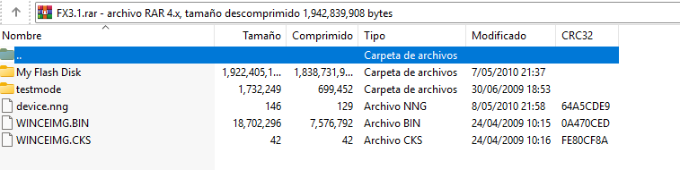

wanted to post a couple of solutions that worked for me after trial and error (and reading every post!)...
1. Tried it on my new macbook pro and it didn't work (although didn't do much exploring since i had access to a windows machine...)
2. Use winrar like everyone is saying... its free and worked perfect on the windows machine.
3. Tried two sd cards and one didnt work so definately try that if you cant copy the rar file.
4. I copied everything and got the dreaded black screen. reloaded the files on the SD and it worked perfect.
5. Didnt need to erase anything on the units disk... The newly loaded sd I guess clears it...
6. And this is the most important!:
Once in the windows CE screen use a pointer or something pointy and plastic to navigate the menu (I used a plastic pen cap).
go Start-control to select the sd card then open and select one item in the folder, go up to top (edit) and select all and then copy...
go to the pioneers flash, select by tapping it, then up to edit again and paste...
that was the unclear part for me. after that then you'll see the time to transfer.
remove the sd card then use a pen or something to hit the reset and viola!!!
If anyone needs some specifics you can send me a msg Id be glad to help...
And again Thanks for making this file available!!!!!
So after lurking on this thread for a few months, I finally decided that I should try and install this update on my F90bt.
Short story: Installed, got to reboot step, did that and since then I was in a splash screen loop.
So I decided to get another SD card, reload the files and try again.
So, once I get to "5. Wait until it says restart in the bottom center. Reset the unit and leave the SD card in.", I have waited for about 5 minutes, but the only thing that shows up in the bottom is "reading: Processed 100%" Is that it, or is it really supposed to say "restart" eventually?
OK I think I messed up bad now...
So I tried installing it again with my new SD card.
Got into test mode, I went into the My Flash disk on the unit, deleted all the files and then copied all the files in the My Flash Disk of the SD card. It got to about 15 seconds and then my car died all of a sudden...
Now whatever I do, it goes to splash screen and then straight to black screen...
So I figured, I'd start from the beginning again.
I get to "6. You should be greeted with testmode (It will look very similar to normal windows)" this lasts about a second and then it goes straight to black screen...
I am guessing that, by deleting all the files out of the "My Flash Drive on the unit, I've effectively deleted the operating system... Is that right?
Is there a way to undo my F-up that does not require sending the unit to Pioneer?
Thanks in advance!
EDIT:
Used a new formatted SD card and all worked like a charm, woohoo!!

Hi everyone, new to this Forum. I am hoping I can get some help. I tried this mod and I cant get it to work. I follow the steps but I get get stuck on the part where it says open up Explorer. This maybe a dumb question but can anyone tell me what to do after we install CE and restart the system. I apologize in advance if this is already posted somewhere on here. I have tried two different cards and tried installing many times. Please help and I dont want to send it to pioneer. Thanks in advance.
Ignore the post. Figured it out.

Does this have to be copied into a blank sd? i keep getting reading file 100% and it will not ask me to restart it... i have kept it on for 4hrs and it hasn't done anything
