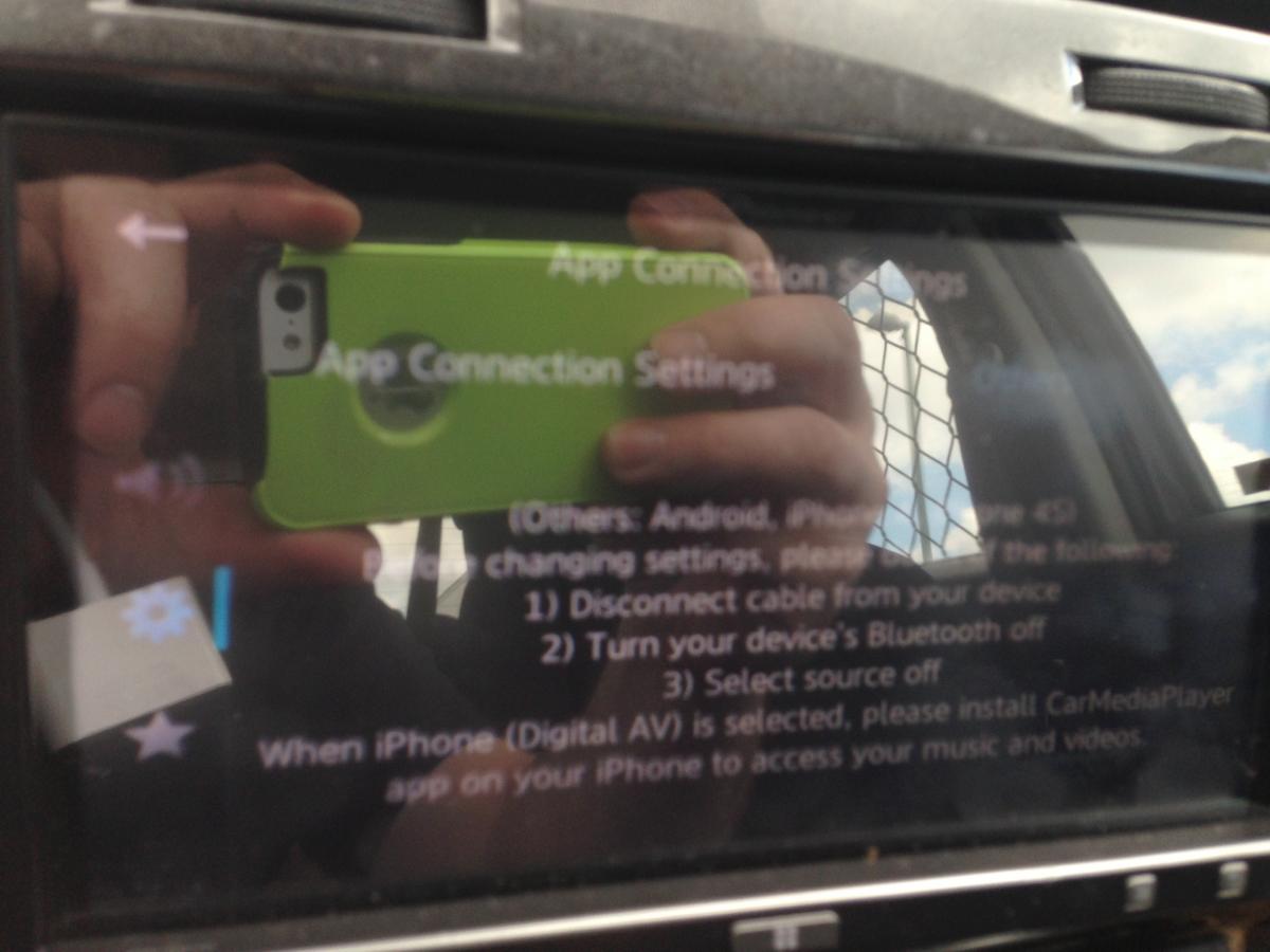

LordDamax Posted March 28, 2013 Author Report Share Posted March 28, 2013 Phone disconnected, BT off. Turn appradio off. Have to turn it back on to get into settings. Click App Connection Settings. It does say Others. But when I click it it just tells me to do what you just did. I can't change it. Now what, Quote Link to post Share on other sites
dannyz3343 Posted March 28, 2013 Report Share Posted March 28, 2013 No don't turn it off all the way. Press the speaker on the second page. That turns off the amp but lets you go into settings. Once you do that you will be able to switch other to iPhone AV Quote Link to post Share on other sites
dannyz3343 Posted March 28, 2013 Report Share Posted March 28, 2013 and again don't have your iPhone plugged in at all. Quote Link to post Share on other sites
LordDamax Posted March 28, 2013 Author Report Share Posted March 28, 2013 When I press the speaker the screen clears and it says Off at the top. I can't do anything til I hit the center home button and turn it back on. Quote Link to post Share on other sites
LordDamax Posted March 28, 2013 Author Report Share Posted March 28, 2013 Pressing the speaker does this: Quote Link to post Share on other sites
LordDamax Posted March 28, 2013 Author Report Share Posted March 28, 2013 Video of behavior: Quote Link to post Share on other sites
asfd64 Posted March 28, 2013 Report Share Posted March 28, 2013 That's weird, with the phone disconnected from the cable and bluetooth you should be able to change that. When you updated your appradio did you copy only the SPH-DA100_SYS_UC_Ver08.30.yuk file to the USB and update then copy only the SPH-DA100_MMD_UC_Ver08.30.hat file to the usb and run that update? Maybe just confirm your update using the instructions here: http://www.pioneerelectronics.com/StaticFiles/PUSA/Files/Car-Firmware/SPHDA100_AppRadio2-FW-Update_v8.30_INSTRUCTIONS.pdf Quote Link to post Share on other sites
