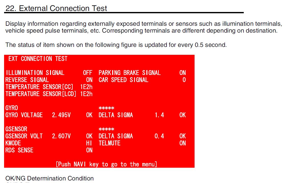

RonS Posted April 1 Report Share Posted April 1 Yeah, I'm starting to think this isn't a case of it being hard-locked due to 3 failed password attempts. In that case I'd expect it to prevent usage at all, while providing some sort of info on the screen at boot time. I see that Navi Settings is grayed-out, so it can't be used to check (via Connection Status) if the Parking Brake is being detected as "On". However in TestMode, # 22. External Connection Test shows its status. From the maintenance manual: Quote Link to post Share on other sites

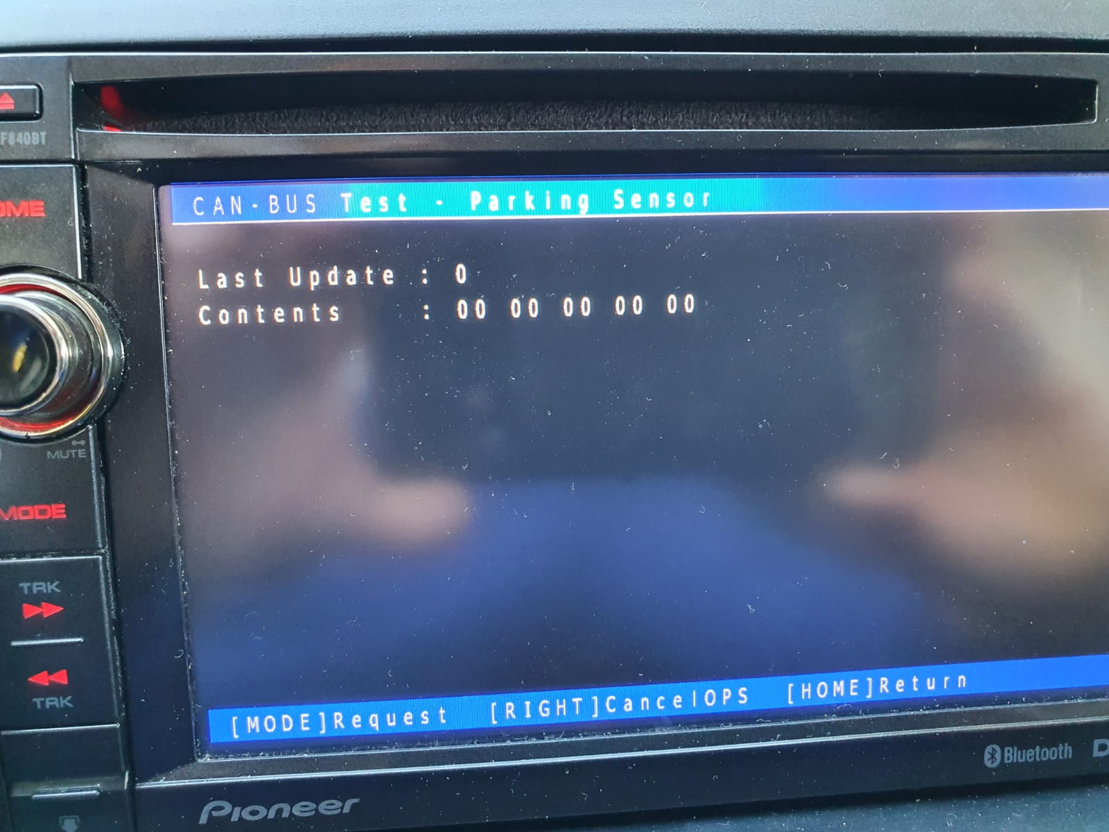

salfrax Posted April 4 Author Report Share Posted April 4 Hi RonS, thanks for your courtesy. I went in "testmode", but the menù is different (probably is different for F840BT model). I find a similar item at #33 as you can see in attached photo; unfortunately, however, I cannot understand the meaning of the output. Quote Link to post Share on other sites
RonS Posted April 4 Report Share Posted April 4 I don't know enough about your car or the F840-BT to say whether that CAN-BUS test applies to your situation. Some cars use CAN-BUS to communicate between various components. You would need lots of technical info about your car to know if your parking brake has a CAN-BUS interface. Judging by that last picture, it doesn't seem to be connected via CAN-BUS. There might be more info in the F840-BT installation manual. Most cars just have a simple switch as part of the parking brake lever/pedal. The headunit just has a parking brake wire in the harness that is supposed to be connected to that switch. Many people just ground that wire (to fool the headunit into thinking the parking brake is always set) instead of connecting it as shown in the installation manual. Quote Link to post Share on other sites
