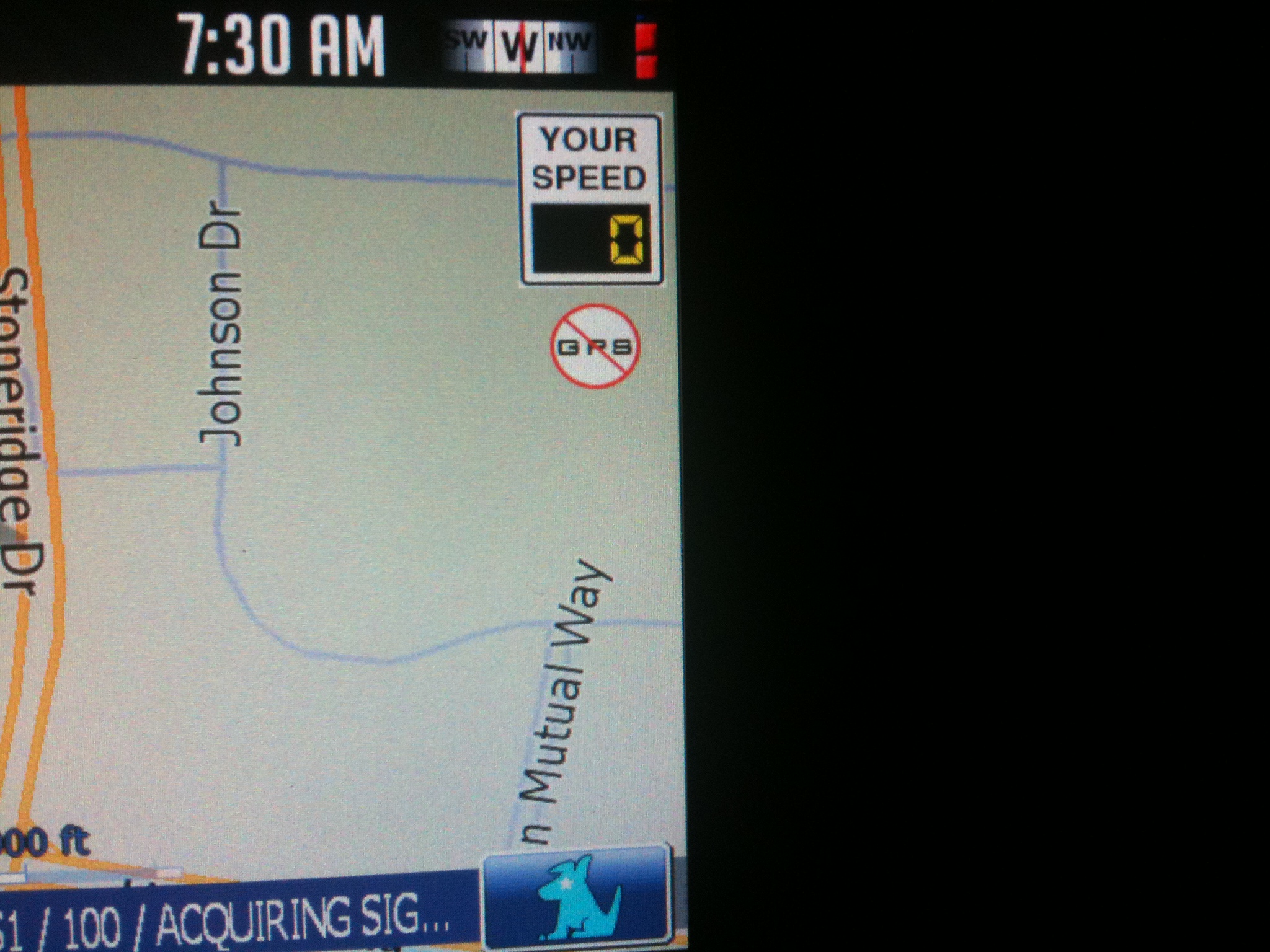

10/8/09
Added a no GPS Signal Icon for when GPS is turned off or no signal is detected.
Made the text larger for distance to destination and time to destination/waypoint toggle.
Made it so that distance to destination brings up itinerary
Cleaned up the text in the settings to hopefully better reflect what the secondary direction distance settings do.
FIxed the full screen cockpit to show an alternate view for people that do not like a lot of information on the navigation screen.
Changed the house numbers to follow suit with the theme of the mods.
Fixed a problem where the mute icon was not showing on the speedo screen when navigation was muted.
Fixed an issue where when the signpost was very large it would overlap a the your speed sign slightly.

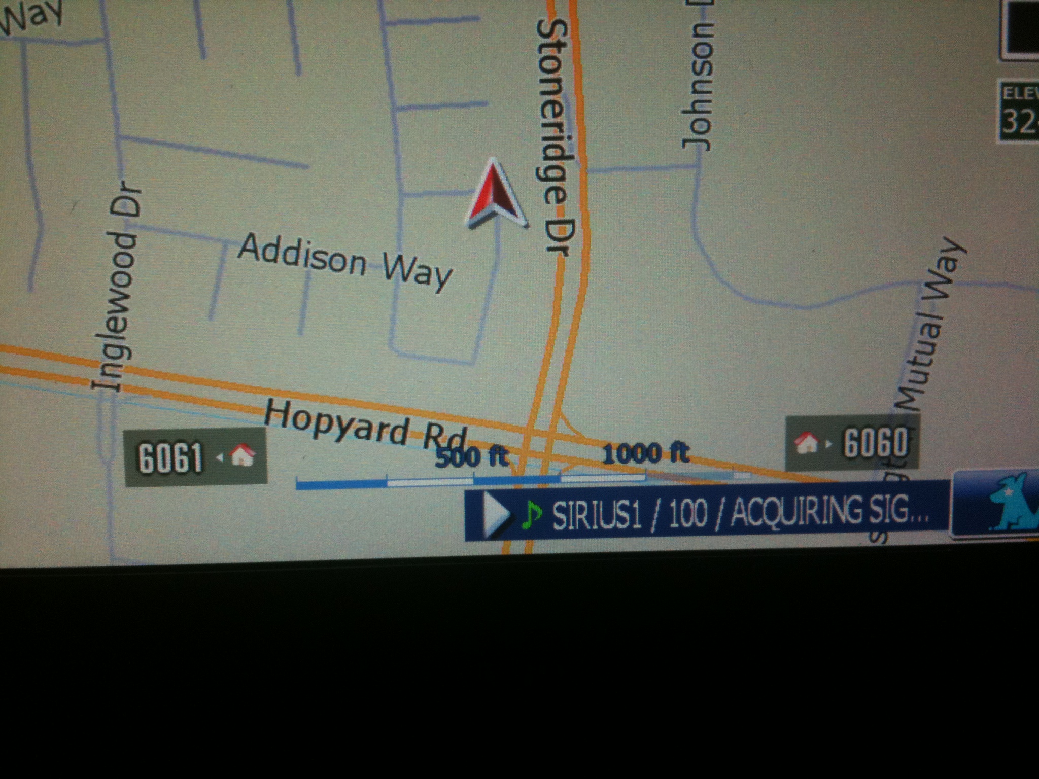

Posted Oct 08, 2009 · 18:05 UTC#499
I just noticed that the GPS knows what side of the street house numbers are on. Is there anyway to make it announce which side of the street the destination is?
Posted Oct 08, 2009 · 19:11 UTC#500
That is supposedly done separately in a voice file. I don't think its in the data.zip. There was a thread on here about it but from what I read nothing conclusive that the voicefile posted on the forums actually solved the problem. I have no problem bundling it in if someone can actually locate a file that for sure has been tested to work.
