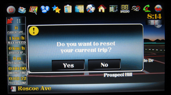

Another one - Abb RealView Night
Posted May 20, 2010 · 01:43 UTC#378
Spectacular!!!!
That Sun, combined with the scenic view background I think would be really cool too. You have some serious talent Abb.
Thanks for all your time you spend on MY unit.
UhhOhhhh, that didn't sound like I meant it to. err, radio
Posted May 20, 2010 · 02:45 UTC#379
Spectacular!!!!
Thanks, my talent is strictly in graphics. The coding I learned from all the more so talented members here, such as IDT, Diaftia, DpDurst And BorisM :).
