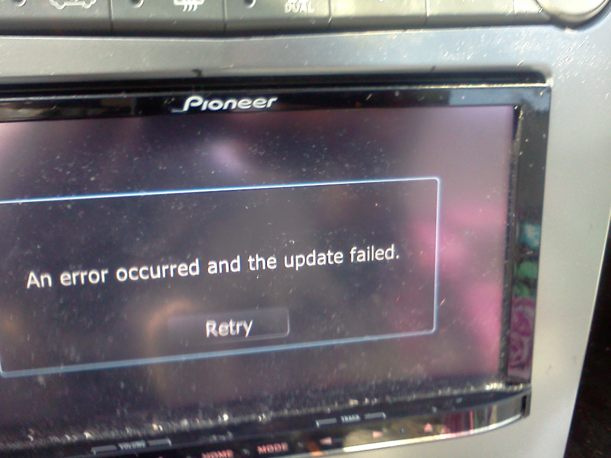

i did the update but when i stick in my sd card for the part 2 i got it updated all the way to 28% then failed. now when i try it i keep getting update failed retry.
I have since then booted to test mode and tried to force the update and on the first sd card it goes all the way through then says error failed and tells me to reboot.
is there a fix or am i just sol
What exactly do you mean "part 2". I don't have a checklist handy. Assuming you mean the SD1 update, sounds like you are having SD reading errors. Try another 4GB SD, freshly formatted as FAT32.

well thats great because i ordered this discs from ebay. i tried putting them on different sd cards but they had the same results.
here are pictures of what i am getting.
u can see in the second picture where it fails.
OK, sounds like you bought (or thought you did) a legit copy of the Pioneer update. If so, why are you posting in a "Crack" thread in the Hacks sub-forum? Should be "Troubleshooting".
From your post, I thought you were having trouble with the hack. If you bought the update, call Pioneer or your ebay seller. So far, these errors (not completing the update) all seem to be media or corrupt image related. But that was with bootlegged images. If your's is legit, you should have recourse.
