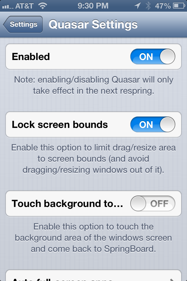

This is what he is talking about, check it out:

It's very possible. Does anyone have an iPad to try it out? Or how do you get it on the iPhone?

Install Quasar
Plug the iPad into the head unit
Launch the AppRadio app
Launch another app
See if the AppRadio app stays on the head unit while you use the other app on your phone.
You may have to try changing some settings, never used Quasar before.
Edit: The description for the app says "Not compitable with iOS 6".
Edit 2: The dev is still working on the update.  Source
Edited Feb 28, 2013 by mikedecaro

Quasar is almost done with iOS 6, he is testing it on his mini. I have put it on the iPhone in the past and a had success. On mac you use better zip to extract the .deb and then in the control file just remove the ipad dependency and it works. Just couldnt resize windows. the developer might even put in support for iphones in the iOS 6 version. But if not we can get it on there. Anybody with iOS 5 want to try. This one I modified to work with iPhone
https://www.dropbox.com/s/sxl7b80yvzs6loc/quasar.deb
Edited Feb 28, 2013 by Tomfoolery82
