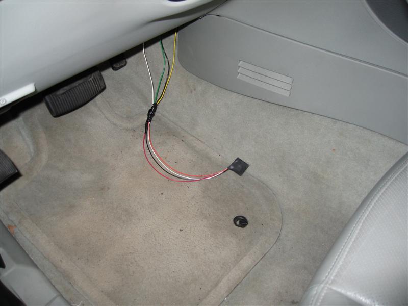

And the very first Ducati Headlight Flasher circuit is installed and working with not a single glitch. I kept my headlights on just to test, but it works no matter what the headlights are doing (on/off/auto/etc). I have envelopes and things in the truck, I hope to have these out tomorrow (if all goes as planned). I hope to have all the first 17 out if possible (I might need to one of the techs at work tomorrow to goof off and build these instead of doing real work, but I think I can pull that off).
I really set out to be very personable with the email and pm corrospondance but I'm getting hammered with requests and spending a lot of time trying to build these as fast as possible (and test them as well), that I might sound short or annoyed or not very talkative in personal emails and Pm's. If I do, I apologize. I'm just trying to focus on the devices themselves and to get you a reply of some form asap.
Anyway not to brag too much, but it's installed in my truck and working great.
Notice I ran some wired out from behind the radio to under the dash, I was getting sick of pulling out the radio to run tests :)
