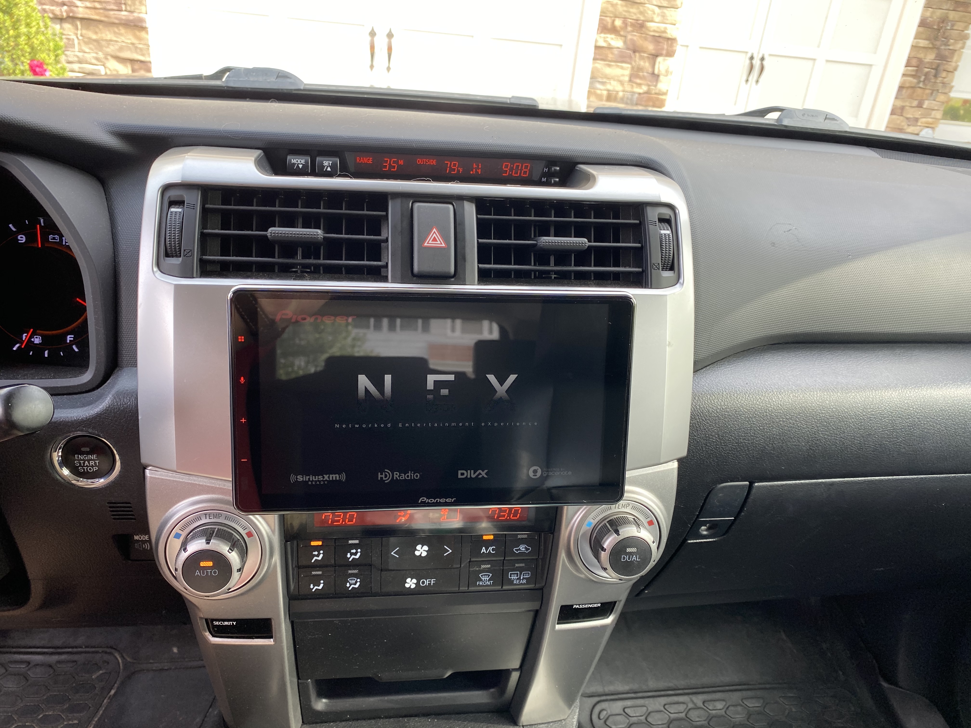

I received and installed my WT7600NEX yesterday!
I went with the 7600 because the 8600 screen would simply be too large to fit between my center vents above and the climate control panel below. The two units are identical other than the screen size.
And that screen!!!! I definitely don’t need the 10” screen of the 8600. The 9” screen of the 7600 is PLENTY big enough, and an enormous upgrade in size and pixel density from previous 7” NEX units. It really is gorgeous, and makes the user interface easier.
Installation was ALMOST a straight swap for my old W8400NEX. The audio wire harness had to be changed, but that is easy as it is all RCA plugs. The new unit uses USB-C, but includes a C-to-A adapter in the box, so I did have to pull my old USB-A cord to run the included USB-C extension cable.
The new NEX software is typical Pioneer. Those familiar with the old NEX software shouldn’t have too difficult a time using the new. Most changes were done to bring the UI up to date and to support new internet-connected features and Alexa. I love the new Home Screen customization options! The live tiles are customizable and swappable. You can have up to four. They can be resized, removed, and replaced with other functions... weather, sports, gauges, climate control, etc.
As for aesthetics, there are new dynamic backgrounds with effects that use the colors from the album art within the NEX interface. It’s pretty cool, and a welcome update to the theme colors, which are also still present.
Alexa support is serviceable, and more so if you plan to ONLY use Alexa, and not CarPlay or, presumably, Android Auto. I honestly don’t see myself using it much, as it requires temporarily disabling CarPlay to use it. This is done as if it is a separate source. I understand why they do this, and I don’t see a way around it, but it would be nice if I could say and use “Alexa” while using CarPlay. Since 90% of my time is spent with CarPlay, I really don’t expect to use Alexa much, but if that is your ecosystem of choice, you should be happy...
...that is if the unit maintains a good hotspot connection with your smartphone, which it relies on for internet. My iPhone hotspot feature seems to go to sleep, and I have to go to the iPhone hotspot setting to wake it up before I use it.
My biggest nitpick isn’t really a nitpick, but more of an “oh, shit, they got me!” Pioneer does not advertise built-in navigation with these new WT NEXs. I didn’t really look for it, as I just expected a $1000 head-unit at the top of the NEX range to have it. Alas, they do not have built-in navigation. Now realistically, this isn’t a big deal for most, as pretty much any nav app on CarPlay or Android Auto blows away the stock nav system... and has free rolling updates! But those who live in or travel to more rural areas will need to take note, less you go to use your preferred navigation app only to be confronted with a blank grid due to a lack of cell coverage. Leaving built-in nav out seems both skimpy and forward-thinking at the same time on a unit of this stature.
Let me know if anyone has any questions!
