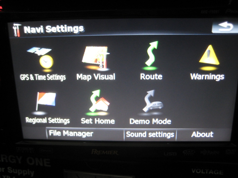

FourG Posted August 19, 2009 Author Report Share Posted August 19, 2009 WinCE is the operating system of the unit. It is always running anyway. Explorer can be started, though. Or better yet, Total Commander. OK, Total Commander works, though it won't let you overwrite files in use (like DATA.ZIP) while iGo's running on the system. So you'll still need TestMode for updating some of the hacks. I tried "\Windows\explorer.exe" first but after launching the graphics in the APL applications got all screwed up by the start menu displaying over the top of the apps. Process I used to add a "File Manager" button to the "Navi Settings" menu in the official F90BT 3.0 (iGo 8.3) DATA.zip: [*:27jew9fr]Using 7Zip, I opened DATA.ZIP (Right click, select "7-Zip"->"Open Archive" from the context menu)[*:27jew9fr]In the 7-Zip file manager, navigate to the ui_pioneer\common\ui folder. Highlight "advmenu.ui" and hit F4 on your keyboard to edit the file with your configured editor. I used vim so it would let me forcibly overwrite the file.[*:27jew9fr]At the bottom of the file, I added the following lines:;!!!fourg adding FileMan launch script, replace the command below with your favorite [*:27jew9fr]Force-save the file (in vim, this is :w!) so 7-zip will detect the file has been updated.[*:27jew9fr]Quit the editor[*:27jew9fr]7-Zip will prompt you that "File 'advmenu.ui' was modified. Do you want to update it in the archive?". Click OK to update the .zip file's copy with your changes.[*:27jew9fr]Now that we've added the script that will launch our command, it's time to browse to the UI that will actually display the button to call the script. Pioneer's put their "Navi Settings" menu under the DATA.zip's ui_pioneer\800_480\ui\ folder. Navigate to this file in the 7-Zip file explorer.[*:27jew9fr]Highlight "setting_800_480.ui" and press the F4 key to edit.[*:27jew9fr]I added a button in the footer of the "ui_navisettings" layer to call the FileMan launch script (which is what calls Total Commander in this example). Browse or search for the "ui_navisettings" layer, then scroll down to find the line of code that looks like this: I inserted the code for the button and an additional separator above this line. You'll probably want to play around with the "x=" value to get it lined up perfectly, but I wasn't anal enough to do so for this example. Add the lines: above the line of code that defines the button for Sound Settings.[*:27jew9fr]Once again, save the file you're editing (:w for you vim'ers).[*:27jew9fr]Exit the editor.[*:27jew9fr]7-Zip will prompt you that "File 'setting_800_480.ui' was modified. Do you want to update it in the archive?". Click OK to update the .zip file's copy with your changes.[*:27jew9fr]Quit 7-Zip[*:27jew9fr]Copy the updated DATA.zip file to your SD card with carver's Testmode 2.3 on it. We're going to be copying some files out of carver's Testmode folder, so you'll want to use it anyway.[*:27jew9fr]Boot into Testmode w/ the SD card (no, I'm not telling you these steps because if you can't get into Testmode, you have no business hacking on the system yet anyway, go search the Hacks forum first).[*:27jew9fr]Once in Testmode, open up Total Commander[*:27jew9fr]Navigate to "Storage Card\TESTMODE" in the left window and "My Flash Disk" in the right window.[*:27jew9fr]Making sure you have selected "Utils" in the left window, select the "File"->"Copy/Move" command[*:27jew9fr]Tap the "Copy" button to copy the "Utils" folder to the root of "My Flash Disk".[*:27jew9fr]Now in the right-side window, navigate to the APL2\iGo folder[*:27jew9fr]Highlight the "DATA.zip" in the right-side window[*:27jew9fr]Select the "File"->"Rename" command[*:27jew9fr]Rename the file to "DATA_orig.zip" or something easy to identify that it's the original DATA.zip file[*:27jew9fr]In the left-side window, navigate to the folder you saved your modified DATA.zip in.[*:27jew9fr]Making sure you have selected the "DATA.zip" file in the left window, select the "File"->"Copy/Move" command[*:27jew9fr]Tap the "Copy" button to copy the "DATA.zip" file to "My Flash Disk"\APL2\iGo\.[*:27jew9fr]Eject the Testmode SD card and reset the system[*:27jew9fr]Once the system has reset, you should be able to select "Settings", then "Navi Settings" to see the newly added "File Manager" button in the footer. To restore the original setup, simply delete the APL2\iGo\DATA.zip file, rename DATA_orig.zip back to DATA.zip and delete the "Utils" folder from "My Flash Disk". Quote Link to post Share on other sites

FourG Posted August 19, 2009 Author Report Share Posted August 19, 2009 FourG, would it be possible to incorporate your mod and Miotoo's wifi mod (viewtopic.php?f=34&t=26523)to where you could have a button and it launch Mio's Opera browser mod? Yeah, it's kind of "Step 1" for that mod, which in reality is exactly the same as the one MioPocket already does for the Portable Navigation Assistants that run Windows (Mios, my iPaq 310, etc, etc). We're just porting it over to the AVIC piece by piece. I would have the script call a MortScript script file to copy the Spectec driver DLLs over to \Windows, update the registry for the driver and then call Opera. I would, *if* Opera hadn't caused a Fatal Exception when I tried to close it which restarted the system. We also need a way to enter SSID/WEP/WPA information, so you can use it on secure networks. Still testing. Quote Link to post Share on other sites
