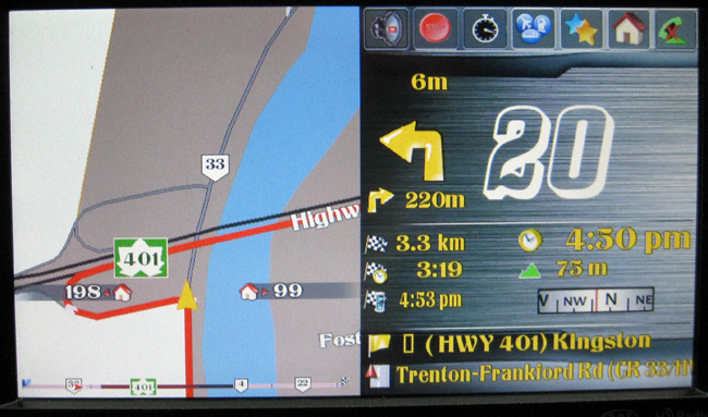

Oh yeah, I remember that! i couldnt find out what he was talking about. None of the text here seems to be squeezed together. Hmm, it could be that he is using a different font. Here is screens of the old and the new....
Posted Apr 15, 2010 · 04:06 UTC#148
hmm, chuck are you having the same issue? I'll have to check what font I have on there, I may have loaded abbs font and never deleted the old ones.
Posted Apr 15, 2010 · 11:59 UTC#149
Well, frankly I didn't observe this issue. I just remember your post so I brought that to Abb's attention.
As far as this Nav Mod is concerned, the only new font that Abb has introduced is the BULL3D... something, which is solely used for the current speed display. FYI, for other Nav Mods, no, you don't have to delete the old fonts to use the new ones, the old ones will just seat there useless.
Note however that the font in the the screen shots provided by Abb is not the same as what we have in our units, because he changed the default font for the display of street names, time etc. You can see my font been used in the photo of the first post on page 3 of this thread ... I guess you should have the same.
Posted Apr 15, 2010 · 12:59 UTC#150
In the next update, I will include the default fonts that I have overwritten so that everything will look the same. I will just put it in a seperate folder and leave it up to you guys if you want to install it or not. I had several requests for these fonts that I use, but didnt want to include them because fonts are a personal preference and not for everyone.
