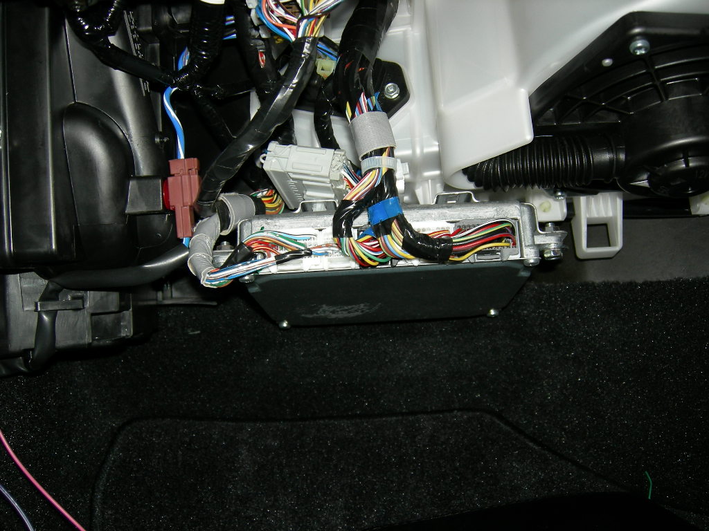

Hey thanks, I tried this, but there is like two ECU boxes? I attached a picture. Anyways, do you have a diagram that shows which cord goes into which. Oh and also, I want to (gasp) install this the right way, and ground the park brake wire (if i need to re route i can slightly activate the park brake) where do i do this? i believe it is the green cord?
(my dad is hooking it up for me, and he dosent want to do the bypass, really no big deal for me because i can slightly pick up the PB without stopping and it iwll be fine!)
check out the pic, thanks for your help!!!

I only see one box in that pic. the speed sense should be in that left most plug. If you look closely at the plug you will see small numbers at each corner just count over and you should fine your speed sense wire. which if memory serves me you'll want to hook the pink wire of the avic to the speed sense. The purple /white will get hooked up to the reverse wire and finally the green wire would be hooked up to the parking brake wire. By the way even if you engage the parking brake 1 click the gps will still lock out the video once you're going more than 5 miles an hour.
Parking Brake green/orange - parking brake switch
To get to the parking brake wire you're probably going to have to remove the center console. Anyway good luck and happy installing.
