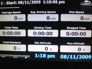

69sixpackbee Posted August 11, 2009 Report Share Posted August 11, 2009 I already commented it out BEFORE I posted the code my bad. It was conflicting with the other text so I saw what to fix. I DO have another issue though. It seems that the last time I used the tripmeter mod (in V2) it still would not work every time. Just some of the time. When it does work it works great but when it doesn't the screen displays all zeroes...regardless of how much I "reset" the trip meter. Sometimes I shut the system down completely and re-start the system and it will still show all zeroes. Not consistant. The clock in the lower RH corner is working yet the time in the tripmeter(s) stand still...they will change upon reset but still remain frozen. What makes this tripmeter do this? Is there a string in the code that grabs the clock? Isn't it supposed to reset upon power down?? I had this problem before and no one could help. I really like this feature but it sucks that I cannot depend on it  Thanx, Bud Quote Link to post Share on other sites
