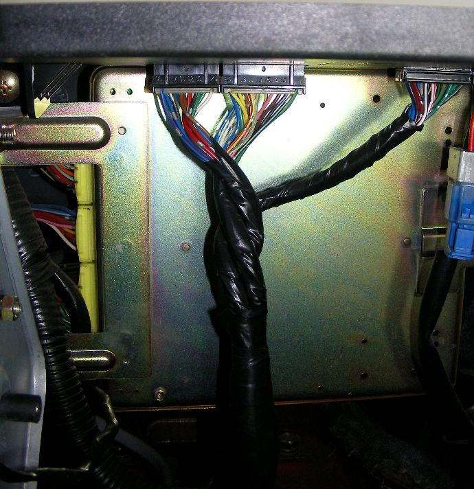

I'm installing it right now ... but not sure I'm in the right area for the VSS. Is it one of these cable clusters?

It's in one of those yellow plugs in the background.

Thanks for the help, I actually think I found its pin number (66)
http://www.stealth316.com/images/ecu_91-93_3.gif
Unfortunately thats a little too tough for me, so I hooked up everything else.
I'm pretty happy with it, got the reverse signal and the camera and the bluetooth, and the ipod all going .... how bad is not having the vss?
I heard someone say you lose 3D mode? I haven't really dived into the unit so I don't even know what 3d mode means?
