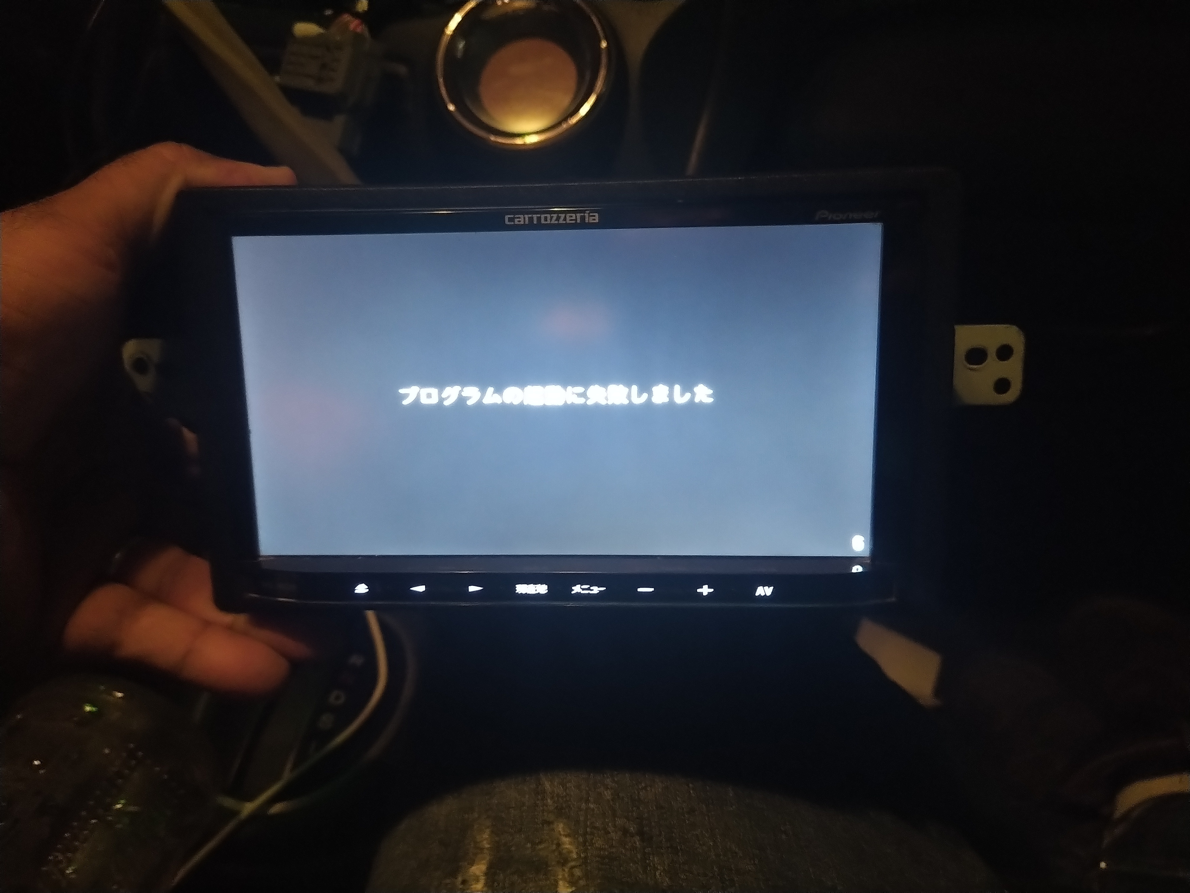

Hello friend, but I need all the files, the user folder is empty, the ones you sent me were PRG0 AND PRG1, I need the others, I am missing those of VOLUME, RW, SETUP AND SYSTEM, they are for the mrz07, please, if you have them, could you send them to me, I need those files to make the radio work are the ones in the photo

someone sent this link a while back, this is system of MRZ09 will all volume, rw, setup and system, so maybe replace prg0 and prg1 with mrz07 then maybe work?

I also accidentally deleted files in the PRG0 folder in my avic-mrz99 while using your code to change the language and now it says Failed to start program. please share a link to the PRG0 file

https://mega.nz/folder/O3pHwIoK#PViNfdIVca0qBcVeMo0nfg
